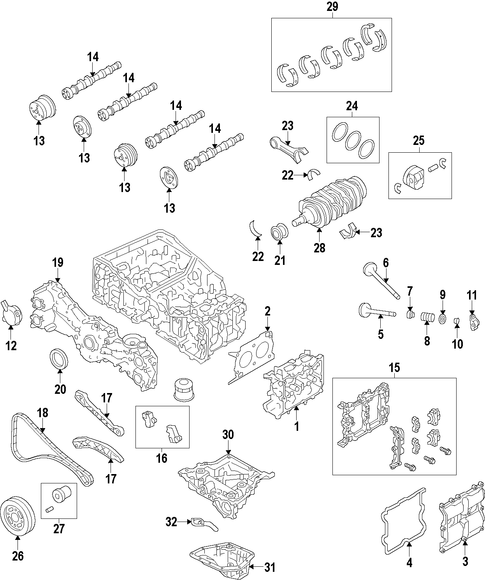

MisterSheep. If you're curious, I got my car back today. Here's what they did. I can't decipher everything on here, only what the service rep told me before. They also drove it ~ 150 miles and changed my radio stations . Also my gear indicator on the dash does not display now but I'm sure there's a fix for that I can do myself. I'd take a pic of my invoice but my phone camera is cracked, so I'll just type up some of it real quick. Here's what my invoice says:
I take vvti sprockets are sticking. Codes p0016 b1 s "A" p0018 b2 s "A" cam/crank shaft correlation case#153270966 replaced b1 and b2 intake vvti sprockets and actuator. As per tax case#153270966. 140021 4.1 8A/83
Qty # Desc
1 SU003-05179 Spkt at-cms. Int L
1 SU003-05177 Spkt at-cms. Int R
2 SU003-00332 Ring-back up
2 SU003-02191 O Ring-44.0X2.6
2 SU003-00096 Valve any-oil cont
1 SU003-05186 Unit-egi control
1 004403007 TB gray fipg
1 00272-GTBC1 Gt super llc blue
2 SU003-00332 Ring- back up
Car felt good for the 10 miles I drove it. Hopefully everything is ok now. I will take it out for a longer drive tomorrow.
1 SU003-05179 Spkt at-cms. Int L Cam sprokets/actuator item 13 below
1 SU003-05177 Spkt at-cms. Int R "" ""
2 SU003-00096 Valve any-oil cont -- Oil control valves item 12
1 SU003-05186 Unit-egi control (new ECU engine control computer)
well over $1000 in parts

On my car they seemed to be having loads and loads of problems with trying to figure it out;
Reflashed the ECU, light came back.
Replaced the sensor, light came back.
Replaced the cam gear on bank 2, light came back.
Replaced the ECU, no problems so far.
