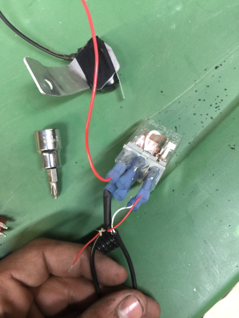

This is the relay. Some wires came unplugged from it. Would you know which, go where?
Edit- the relay is between the connector for the control box, & the voltage reader.

Yeah this is after market. Looks like you have a gen 1 supercharger. Can you find the model number of the relay? I can help you from there.

Sanyou SME-2110AT
Edit: found the diagram so it appears I just need to put new connectors on the red & white wires & connect 3 & 6 with the white/red
This relay is just for the voltage reader?
http://www.ft86club.com/forums/showp...postcount=2399
Here's the wire setup.

I suck at wiring..so should I skip 3/6?
Truthfully I have no idea. I was used to the other relay.

All this relay is doing is supplying power to the voltage reader, correct?
Also automatically shutting down the phantom when the car is turned off.

Thank you for the help. I got it wired up & I will test it in a few once I install the rest of the setup. If it doesn't power on/off, I'll just switch the wires on the relay
Just keep green onside and yellow on the other.
