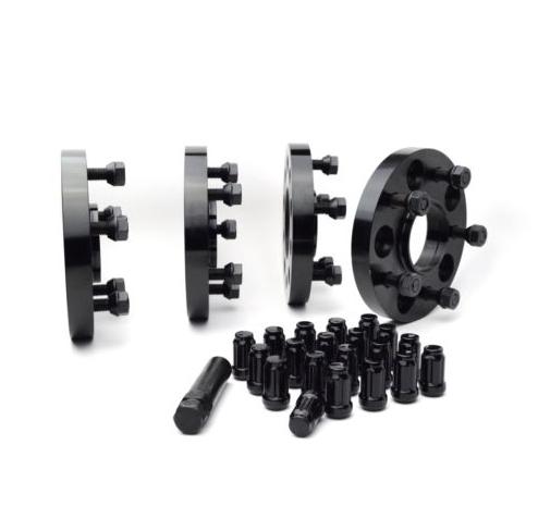

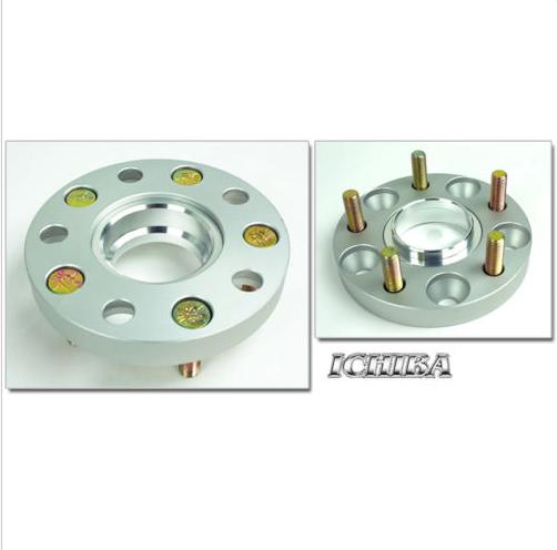

Need help with choosing correct spacers for stock wheels.

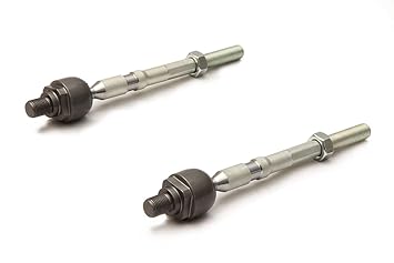

Recently bought Megan Racing Rack Ends Inner Tie Rods, think about 20mm or 25mm. Don't want to move wheels too out of and use different sizes for Front/Rear.
Worry about 20mm, is that enough to prevent rubbing in max lock?

Also what do you guys think about brands?
What REAL difference between eBay Hubcentric spacers made 6061 T6 Forged Aluminum for only $125 (4 spacers) and 2/3 times more expensive eibach, H&R or ICHIBA V2 etc.?
Thanks

I have these inner tie rods. I paired them with Whiteline's roll center correction ball joint, and bump steer corrected outer tie rods. I origionally ran a 17x9+35 wheel with 215/40/17's. it would rub at full lock when the suspension would compress. (i was also way too low)
I raised the car a bit, added 15mm spacer. (so now 17x9+20) Now I don't rub and prolly have a tad bit more angle.
hope this helps!
hope this helps!
Yes sir! Thanks for your answer.
That's exactly what I need
Also, what do you think will be with et25 (10mm spacers)?
