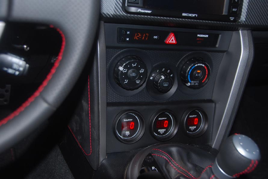

Here's mine. DIY aluminum plate with three 2 1/16th inch gauges.
