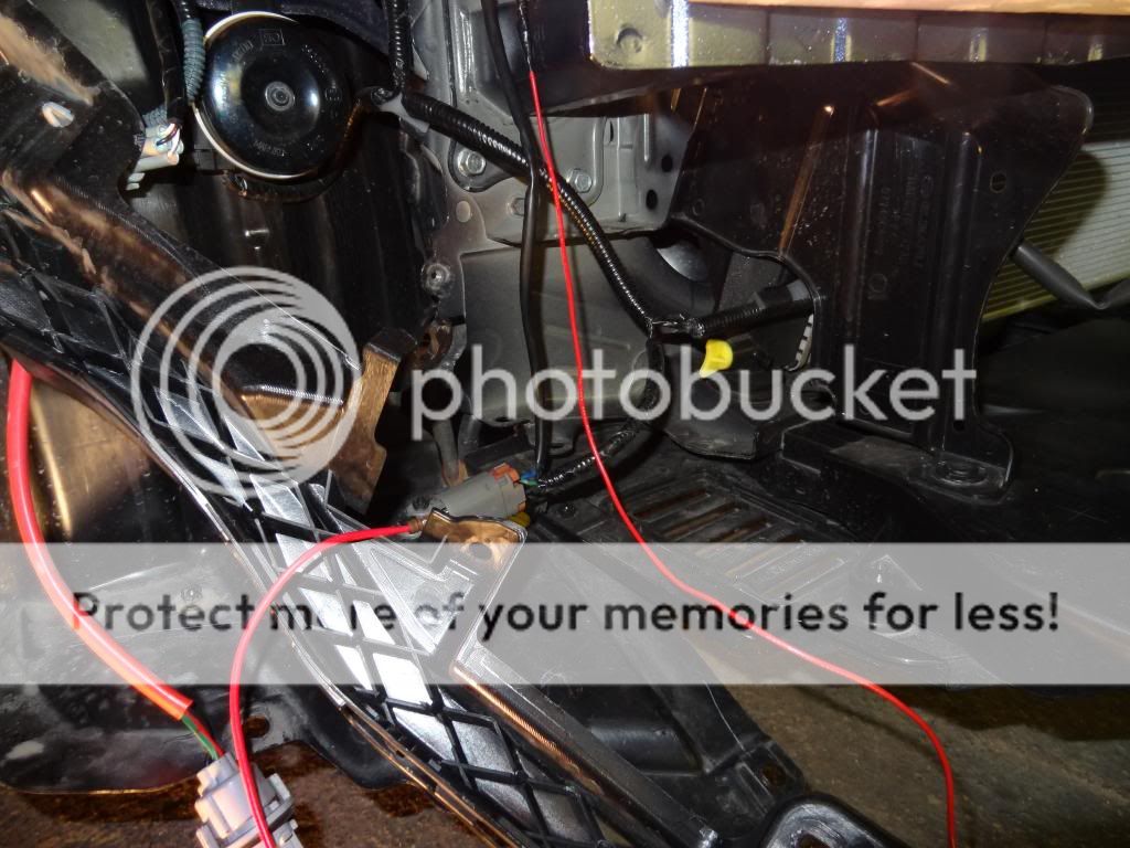

I just wanted to check if I wired everything up correctly from the starting from the top left row is pin number 1.
I'm tapping 12v power for the DRL's just below the horn assembly but DRL's do not light up when driving regularly.
If anyone can correct or verify that it was wired correctly I would really appreciated it, Thanks in advance!

Originally Posted by dokterdewe View Post
Are you talking about BCU ? Main Body ECU ???
Correct.
I've read about a DRL resistor behind the bumper, I wonder if it's missing from our cars?
try to look at Moto-P diagram again.. or try contacting him (PMs, or email..)
Originally Posted by sav View Post
Correct.
don't you think the DRL relay slot means it works as resistor too ?
