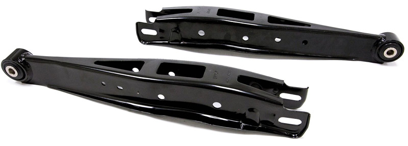

Some LCAs have a bit of different geometry. GTSpec, Stance, etc. I run GTSpec. They have a bit of an angle to them. Helps with lowered cars in some cases.
Yours?
vs
Anyway - just seems weird that there is that much force on that one side. Certainly beefier links may help but maybe something else is going on?
