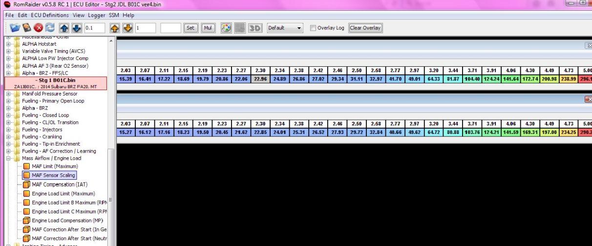

Because you modified the CL scaling, you'll have to continue doing so until it's perfect and you get 0 LTFT in OL.
Originally Posted by JB86'd View Post
@Wayno @steve99 @Kodename47
here's my newest log with the injector scales, UEL load limits, and my custom maf scale (done with injector scales, but before adding load limits). I'm pretty knock free but it looks to be running too lean compared to commanded.
http://datazap.me/u/joshbustos86/jdl...-4-6-7-8-10-13
My custom scale is richer than the stage 1 scale above 3V (where my AFR's were just about spot on without load limits) so I'm now wondering why it's leaner, as I'm not hitting the load limit past 4000 rpm.
here's my maf scale (top) vs stg1 (bottom)
Attachment 122020
SHIT, that's the one variable I failed to realize. I suppose I should just flash my Open Loop scaling and load limits without CL changed, and see how that goes.
Or better scale in CL or revert 2.23V to 3V as that's where the last LTFT bracket is I think.
