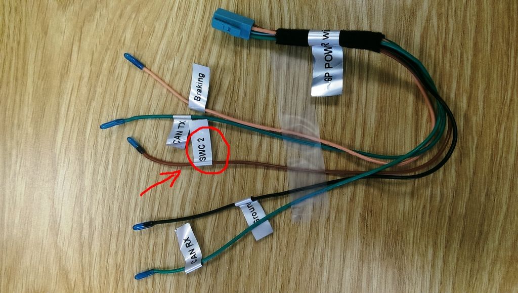

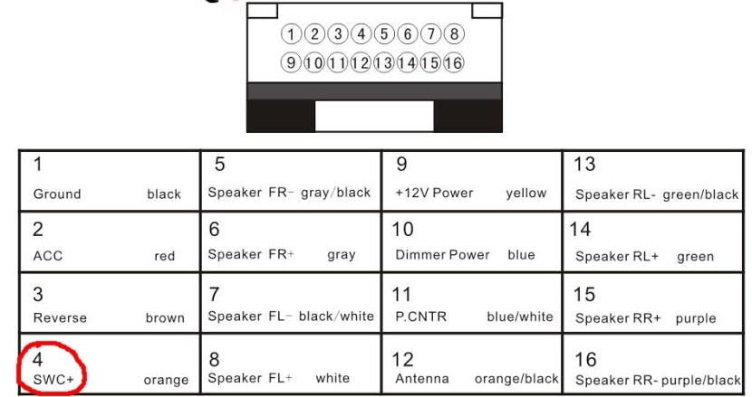

Hi Bros,
I am going to install new Dashlinq CT to my Subaru, which has OEM SWC with 3 wires.
According to dashlinqCT main wiring harness diagram, the OEM SWC-1 wire will connect to pin-4 on DashlinqCT, so where do I connect SWC-2 to Dashlinq?
I found on new Dashlinq CT has addition wiring harness (as see in picture) that has a wire marked as SWC 2, is it ok to connect the SWC-2 (from OEM SWC) to this wire (SWC 2) on Dashlinq?
Please advise,
DashlinqCT main wiring harness:
DashlinqCT addition wiring harness:
Thanks,
TommyGT
TommyGT is offline   Reply With Quote

Originally Posted by TommyGT View Post
I am going to install new Dashlinq CT to my Subaru [2014 Forester], which has OEM SWC with 3 wires.
What is the model number on your Forester's factory HU? (you'll find one printed on the front).
Try this -- connect:
* Dashlinq CT's SWC1 input lead to Forester's SWC1+
* Dashlinq CT's SWC2 input lead to Forester's SWC2+
* Dashlinq CT's extra ground lead (on same harness with their SWC2 input lead) to Forester's SWC(-) / common lead
You'll need to find the menu on the Dashlinq CT to "learn" your cars SWC buttons.
The Forester's SWC wires are either on the 20-pin power/speaker harness (on 2014 models without OEM nav), or on the 28-pin mic/aux harness (on models with OEM nav). I can supply a harness for either of those, so you won't have to hack into the factory wires. For details, see my web site and/or send me your e-mail.
SVXdc is offline   Reply With Quote

Hi David,
Thanks for the reply, my Subaru is Forester 2014 and the HU model is Harman Kardon without Nav, I have ordered the wiring harness from you (20 pin + 16 pin for amp control wire) and waiting for delivery.
As information from previous Dashlinq4 model owners, I'll need to add a resistor (1.2k ohm) to combine my car's 2 SWC signal wires into the single input wire, but in Dashlinq CT there is SWC 2 wire that I am confusing if it's designed for SWC 2 or for other purpose (i.e CAN Bus). In fact I have raise the question to Ca-fi (Dashlinq manufacturer) but no response from them (poor service).
If any Bros have successful installing Dashlinq CT with Subaru OEM SWC (3 wires harness), please feel free to share your experiences.
Thanks in advance,
TommyGT
