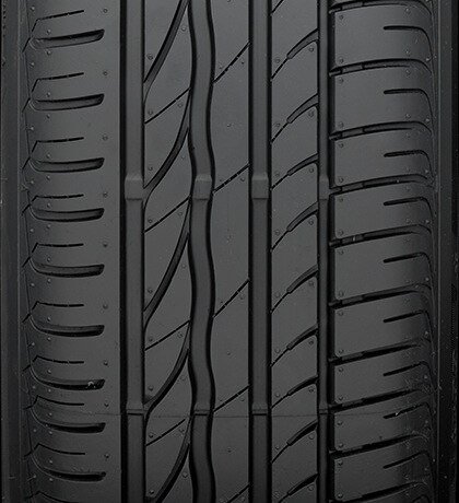

Bridgestone Turanza run-flats served admirably on my old Altima, with zero sidewall flex and remarkable resistance to fade. That car had racing suspension and 1900+ pounds on the front axle and the tires were still responsive, if you want a hard sidewall look no further. They lasted a long time and have great traction, probably why they're OEM for MINI turbo cars. But they lose grip all at once, which frightens me on an FRS, and they weigh 22 pounds. I don't want more than 20. Ride quality is also horrible, and the biggest lightweight size on these tires is 195-width. No thank you.

Bridgestone Turanza run-flat sorta heavy, too stiff, gets heavy in big sizes
The Hankook is softest and has the narrowest outer tread block, the Kumho is second-softest and has the second narrowest outer tread block. The Bridgestone is stiffest and has the widest outer tread block. The runflat Michelin is plenty stiff and has a medium tread block. The width of the outer tread block, therefore, correlates very strongly with driving stiffness.
Meanwhile, the Hankook is lightest and softest, the Kumho is heavier and stiffer, the Bridgestone is heavier and stiffer than still. The runflat Michelin is way heavier, but the second-stiffest. Tire weight seems to correlate weakly with driving stiffness.
So how about that 205/55R16 Michelin Primacy in question? It has the second-widest outer tread block which strongly implies that it's the second stiffest, and it's the second-lightest which weakly implies that it's the second softest.
So it probably ranks about average for stiffness in this group: softer than the runflats, stiffer than the tires I've got. But there's one variable I've been excluding till now: tire pressure. The tires on my car now are full to bursting at 45/46 psi, the runflats were less inflated at 38-41 psi per OEM specs. So that means the run-flats in question were way stiffer. The Primacy is related to the Primacy run-flat, hopefully it's inherited some of that stiffness. All else fails, I can overinflate that shit and add stiffness that way.
