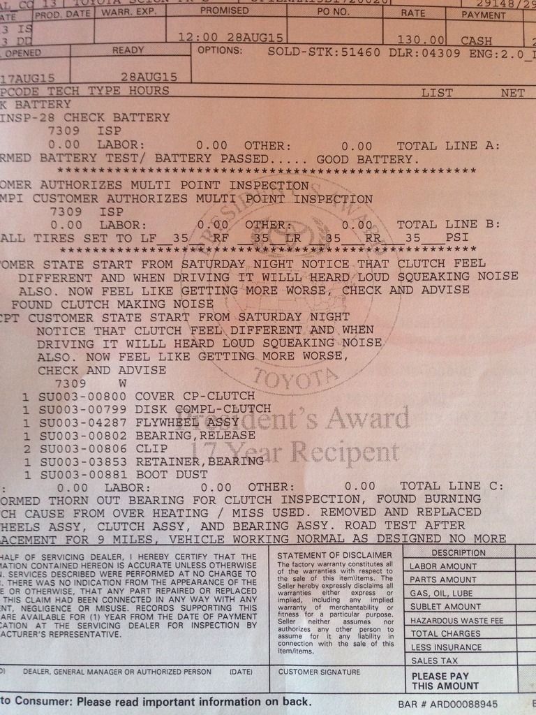

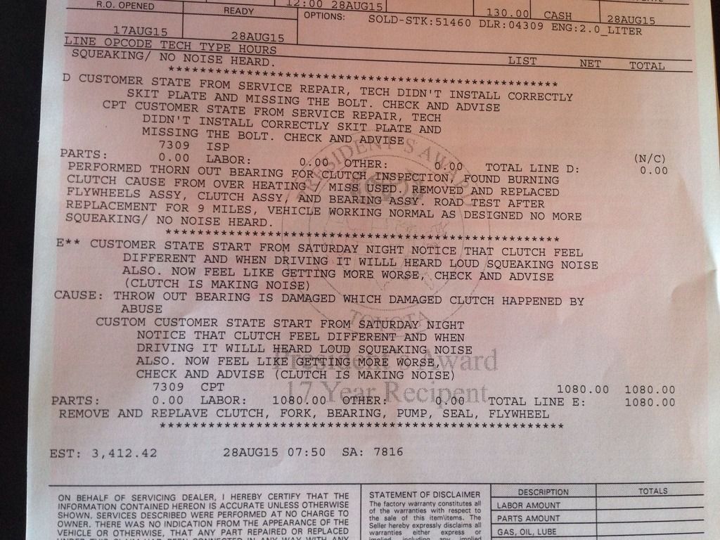

So I'm out $1080 after finally picking my car up after 2 weeks. Toyota covered the parts, as they should. they did not, however, cover the labor. $1080 for a fkn clutch job to replace parts that were damaged due to a defective part... SMH what a fuking ripoff.
They haven't heard the last of me, I'll say that much.
WTF? Either it's a warranty job or it isn't. Somebody explain this to me, please.

So here are my receipts:
As Al Sharpton, or Jesse Jackson might say: "If your service aint great, you got to litigate!"
I think we have the "lemon laws" in Cali and the members on this forum to back us up on this. They'll soon find out they've messed with the wrong mofo, I'll guarantee that.
Cannot see the photos. If they try to deny my warranty claim I will contest it. I think we have a lot of members here with warranty repairs already done to support my claim. This damage is definitely caused by a defect in the part. All your receipts and information will help. Thanks!
Fixed the link. This part seems to be going out on a lot of people. I bet they'll release a TSB on it.
