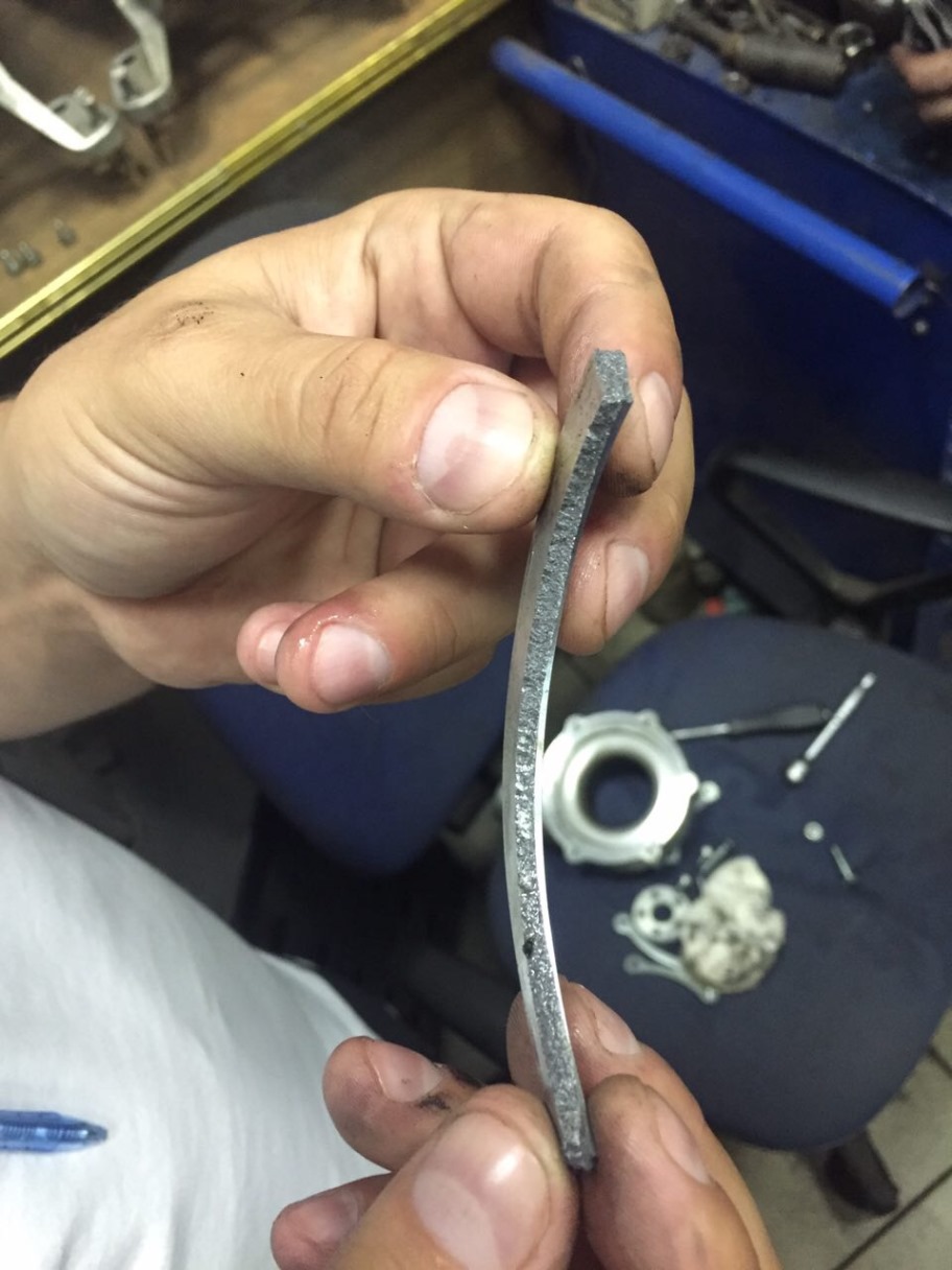

I can sell you mine! Cheap! Requires some welding though, filter and traction fluid
BTW: got news from a fellow from Novosibirsk who installed V1 SC before all of us here in Russia and it failed first too - early this year. He has finally opened the failed unit and the picture was apparently identical to the other two units which failed later including mine: thread on the "cover" is gone. But in his case it went further - the body of the unit was cracked and the fluid went out. Waiting for his pictures - will post here once he sends them to me. This design seems to be totally corrupted.
If the replacement blower which I will hopefully get in Sept fails too - I'll be really angry
UPD: Here are the pics.
Thanks man! very very tempting ha ha... This is absolutely ridiculous and pathetic the company doesn't stand behind their product. Clearly this is a manufacturing problem, not user error.
