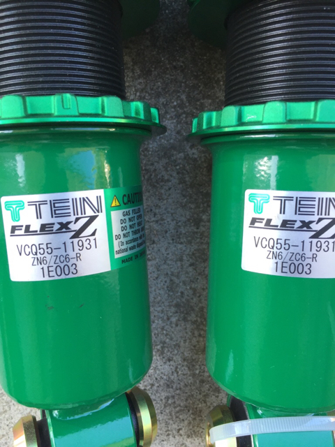

Do the two rear shocks share the same part #? I shouldn't have a ZN6/ZC6-L correct? Name:  ImageUploadedByTapatalk1439769817.200829.jpg

Correct. As R means rear in this instance.

Yes. Rear shocks are literally the same (you can verify with your OEM units as well).
