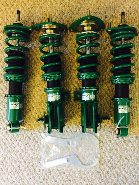

Originally Posted by mit_peid View Post
Received my set of Flex Zs earlier this week. If the green paint is indicative of their quality, these should be much better than the Konis (which arrived with flaked yellow paint) I currently have on my car. Hope to install this weekend. These are my first set of height adjustable coilovers ever. I need to figure out how to adjust ride height. Anybody know what's the drop if I just don't touch them at all? I'm just looking for a drop in the 1-1.2" range.
Attachment 117790
It's recommended you adjust them to spec and tighten down everything. My fronts were a bit out of spec and needed more spring pre-load. Rears were pretty close to spec. Make sure you tighten the spring pre-load collars good before you put them on cause it's going to be much harder after they're on, especially in the rear.
On a separate note I tried 6 clicks at first and felt that was worse than stock, cinched up to 4 all around and it feels better than stock now.
I couldn't figure out if the rears were matched to a left or right but did notice one rear has a small groove in the edge of the top plate. I assumed this was for the left rear.

swarb: "custom" doesn't sound "budget" anymore to me, and in such case i can consider higher priced ones too with no such max base height limit. Spacers doesn't sound too attractive, as while it can get height up, travel will still be limited. I guess it's simpler to wait for someone to respond which case with max height according to such specs actually is, and decide according to that if they are for me or if i should keep on looking what will fit my wishes better.

Originally Posted by CounterSpace Garage View Post
Always measure everything before tightening down every nut, bolt, and collar. This ensures everything is torqued and loaded properly before use.
This is good advice. The fronts were okay, but the "B" distance for the rears for the base ride height (-1.2" drop from OEM) is supposed to 1.4" but I had to adjust the collars from a distance of 2.5"+ out of the box.
Lesson: Don't just install straight from the box expecting uniform default TEIN drop on all 4 corners like I was half jokingly/seriously considering. Measure, re-measure, double-check, tighten everything.
