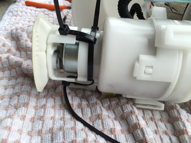

Old 07-19-2015, 10:05 PM   #34
Size:  323.6 KB here is what I did on mine to secure the sock.
