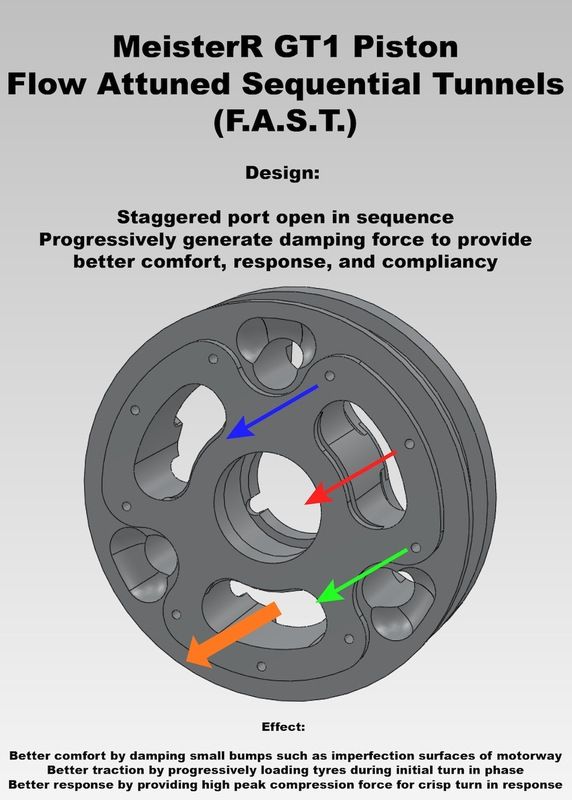

I'm doing my best to get as good an understanding of suspension and dampers as possible as I really do think a good suspension set up is make or break on a car.
However, obviously it's a really complex topic.
What would you expect a damper that produced a graph like this to be like:-
It uses this piston:-
DeaconRoc is offline   Reply With Quote

Ill take a crack at that;
My guess is that it looks like a digressive/linear piston from what Shankenstein posted.
Basically a shock that would be pretty predictable on the street while giving you a decent amount of damping. (Then again i could be impossibly wrong).

Meister seems to make a nice piston and that looks more like a high flow linear piston. I'm used to force/velocity graphs and maintaining uniform units of measure but the compression side is the high flow/lots of bleed side and the side we're looking at in the picture. Basically it dumps a ton of pressure when the shims open with the huge ports.
The smaller ports are the inlet for the rebound flow. Smaller ports allow for higher pressures/forces and greater adjustability range. The adjustable range is excessive. You could run any spring you ever want and never have to change the shim stack on the rebound side but I'd hope it has a lot of clicks that allow you to take smaller adjustment steps or you'll never be able to dial the car in correctly.
I have a piston similar to this in my Corvette and I love it on the street. With so much compression bleed it feels pretty good on pothole ridden streets. I barely notice running over train track crossings.
Thank you for your thoughts on these.
They are single way 36 point adjustable - dialing them in is definitely proving a challenge!
You're 100% right about the potholes though - they soakthem up like no suspension I've ever tried. The internals are made by a company who specialise in rally car suspension which might explain it.
