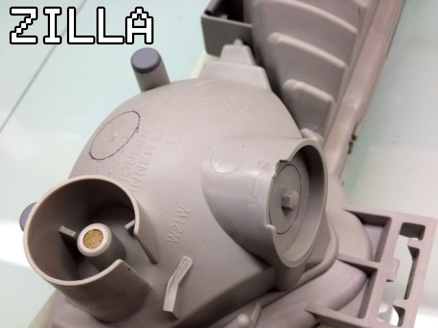

If this wasn't meant to be a 4th brake light then why is there a "lock and unlock" indicator right above the 4th brake light just like the reverse lights ?

Originally Posted by ZILLA View Post
I ran the (+) wire from each 194 bulb to the driver side tail light harness. The green wire is the regular tail light. The red wire is the brake light. The ground wires went to the OEM ground location in the trunk.
FWIW, I just redid the wiring for the rear fog on my car, and the green was the brake, and red was the parking light.
Attachment 114665
Because it's meant to be a fog light.
