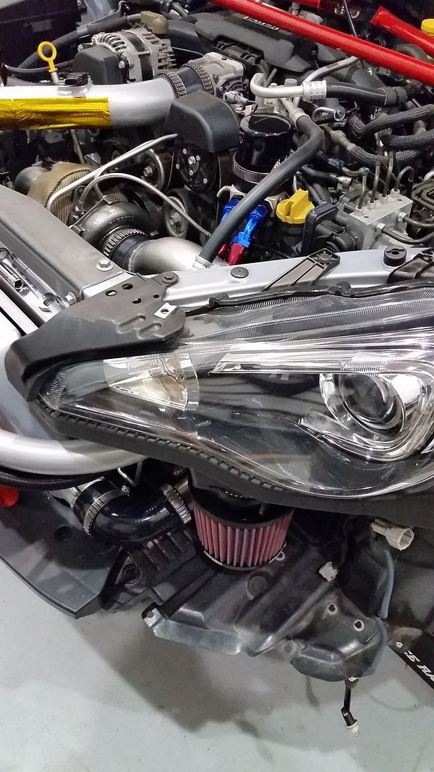

First time the bumper has been back on in a while.
Big GTX35 still fits
New radiator support for more clearance.
Cold Air intake is possible now with the smaller 3" intake turbo.
I changed the lower intercooler pipe routing, much shorter, this should make a noticeable improvement in spool. Not that it was a problem but improvements can all ways be made.

Intake is done, ready for powder. 3" from end to end

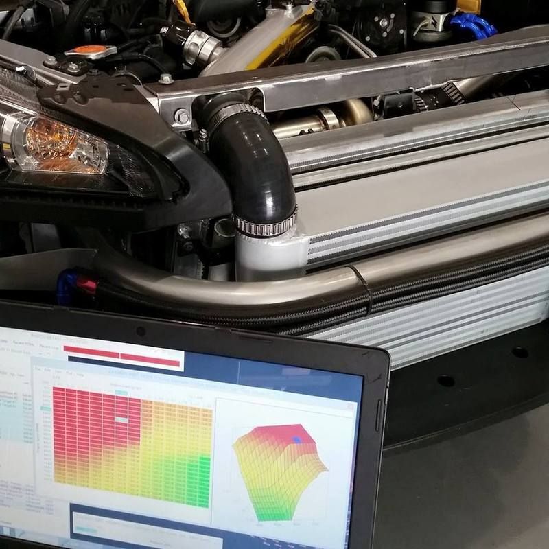

ITS ALIVE!! up and running on the GT28RS, put together a quicky start up tune which is about the extent of my tuning ability. From here I let Mike @ Moto East take over.

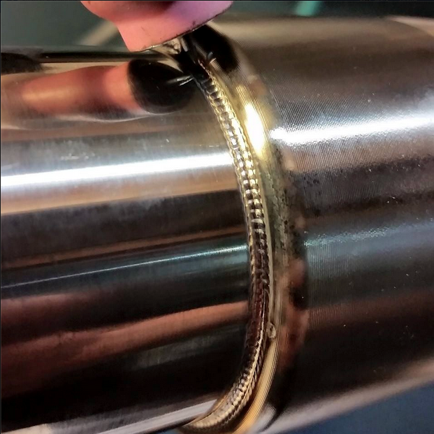

I got a temp gig running an automated TIG setup, I underestimated how challenging it actually is. This is not car related but some fancy sprinkler systems. By the time I finish this 100 some part order I'll have the hang of it.

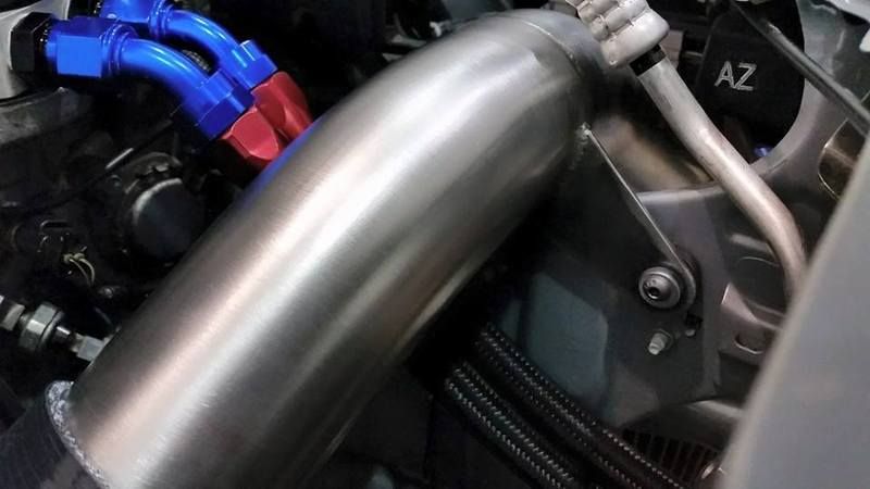

Used braided line and heat sleeve for the eBoost2 control solenoid. Why risk it.
Dialing in the boost controller is incredibly good fun, what an improvement even at the same peak boost.
