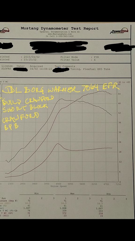

texasbound972 is offline   Reply With Quote

Originally Posted by texasbound972 View Post
This is before and after power blocks on e85?
jaorocks1 is offline   Reply With Quote
This is with the power blocks.

I don't have a before with 23 psi.
