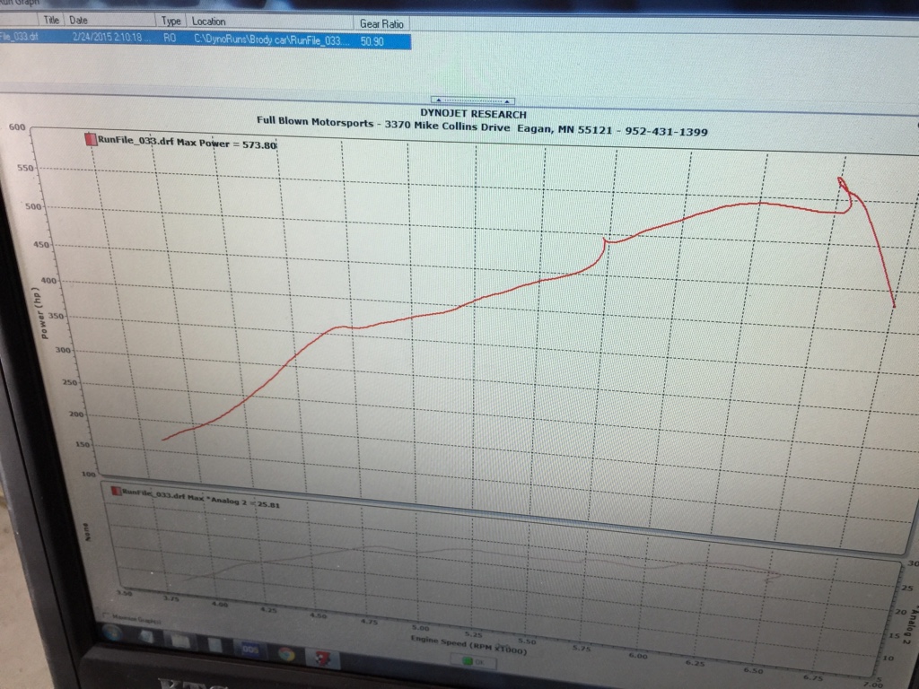

Originally Posted by Brody602 View Post
My car
Build details:
Built FA20 9.5:1 Compression
Fullblown Stage 2 head package and cams.
Fullblown Premium turbo kit with Ported PT5858 turbo (upgraded 750hp intercooler)
Full 3" turbo back exhaust
Fullblown upgraded rads, fans and shrouds
Fullblown oil cooler
Fullblown Stage 1 fuel system
Fullblown Flex fuel kit
3.73 Rear diff conversion
Attached dyno graphs of my 91 pump gas tune, 20 psi e-68 tune and 25 psi e-68 tune.
Attachment 103341
Attachment 103342Attachment 103343
how about some onboard pulls? should be nice
how do you like the 3.73 rear where did you get it? @drody602
