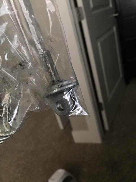

Originally Posted by Kronos View Post
Attachment 107879
So did others reattach this piece? I took this piece, the spring, the pin and the e clip off and never reinstalled any of it.
I did just because I didn't want to lose it somewhere.
I don't think it matters either way.

Anyone know if this is legal for C-Street SCCA?

What's the non-reversible part of this he mentions?
Don't ask don't tell? I really don't think something like this is listed any where in the rule book and I highly anyone would notice or care.
Don't think there was anything about non-reversible. Just that it's a slight pain in the ass since the spring is compressed so much. You'd need some fairly strong zip ties to get it compressed enough to get back in place.
