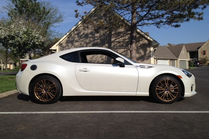

This is the second set of Eibach Pro-kits I've bought for a vehicle and I absolutely love them. first was on my MKII MR2 and now my BRZ. I never rub on anything and the ride feels relatively stock, but the progressive springs definitely stiffen up in the corners.
Definitely agree with Vivid Racing. I've only ever heard good things about H&R and Eibach, which led me to buy the Eibachs for the MR2 and BRZ, and H&R Race springs on my '97 A4. I have absolutely no complaints about either option. I don't know about Tein s-techs on the BRZ/FRS, but I've heard they're too stiff from both Honda and MR2 guys.
Here's what the Pro-kits look like on stock wheels, as well as a set of 17" RPF1's I just picked up:

Not sure on the exact specs of the wheels, but I think they're 17"x9" with 245/40/17 BFG Rivals. Not sure of the offset. Front tires rubbed on the stock strut towers, but a 3mm spacer fixed that.
As far as the springs, I was worried I would upset how the car handled but I really didn't notice much of a difference at all from stock. As far as performance goes, there's definitely an improvement. The initial stiffness feels stock, but when you put it into a turn the progressive spring rates keep it from rolling as much. I lucked out and got a photo of me and a stock car in the same corner so you can kinda see the difference:
After getting sticky tires, I'm right up there with all the other 86's in my autoX region that have coilovers and much more mods. The biggest difference I noticed, however, was when I put in Koni Yellow struts. I have them about 1/3 of the way from soft and they're only a tad bit stiffer than stock. On full soft they actually feel a little softer than stock. You really don't have to put on new struts with only a 1" drop, but I was forced to after I accidentally let the shaft of the strut spin when installing the top nut, resulting in all the fluid leaking out. Word to the wise: don't let that happen haha. Get some cheap offset wrenches to do it correctly. Which is what I did the second time around.
