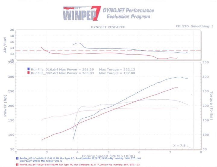

Jackson Racing Supercharger Owners Thread
Completed my first weekend on e85 on the track at MSR Houston. The car ran much cooler and made good power. I was not afraid of detonation at all. The power was smooth and kept on pulling when I was on it. Above is the picture of my dyno on e85 with remote tuning by moto-east. Blue is the after-tune red is the baseline pre-tune. All weekend I was battling with a race-car corvette ZR1 and all other cars I just passed up effortlessly. All of the bigger horsepower cars kept on thinking they could leave me in the straights and they all were surprised I stayed on their bumper.
Youtube Video
[ame]http://youtu.be/Et0h8g_VB_4[/ame]
