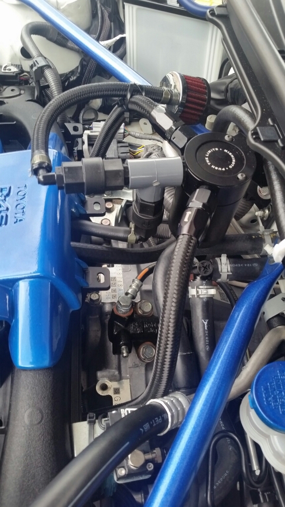

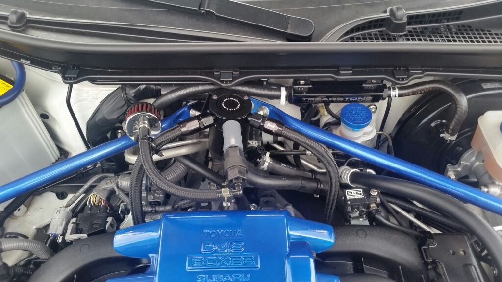

I finished my 3 port can set up. It has both pcv and ccv going in to the can. I have the outlet and check valves going to manifold under vacuum and vent to atmosphere under boost. I had about an ounce of oil blow by after 3 weeks of daily driving.

Could you take a picture of your set up? I want to see how you're routing the tubing and how you're venting to atmosphere under boost. Is this a Mishimoto 3 port can?

Yeah the 3 port mishimoto can and check valves

Thanks for the pictures. I didn't know that plumbing the PCV and CCV into one can was possible. I thought the two systems see different pressures per @Mishimoto and that this type of routing was not possible. Your check valves and vent to atmosphere at boost allows for this?
