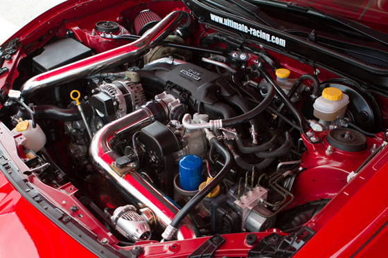

I just chatted with them and asked for install instructions and pictures. They are going to email me the guide and this was the only picture they had on hand: Looks like heat may be a concern and also the battery most likely needs a relocate.

So you have to relocate the battery for this kit?
yea i did to, i am waiting on the email with pictures as well. I wanted to relocate battery to the trunk so thats not a big deal for me, but is the turbo going to create to much heat in that corner?

Is it not a concern to put the intake in an ideal spot for air flow once it's connected to a turbo?
I've seen a few kits that seemingly place it where it's convenient and never knew how much of a difference it makes.
yea i am wondering about this to, alittle confusing as to why they would put it where they did.

Having looked at that location for turbo placement, there are way too many sensitive wires in that area for me to feel comfortable putting a heatsink (turbo) there.

You could most likely get a CF hood with a scoop on it. Im pretty sure there is a few out there that are functional. Maybe even do the mod for the vents on the fenders in conjunction with a molding on the underside to direct the air towards the turbo. Might work...
That intake location doesn't look particularly ideal for air flow.
