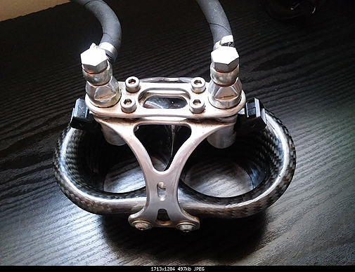

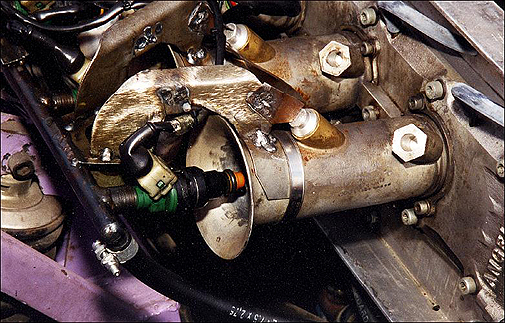

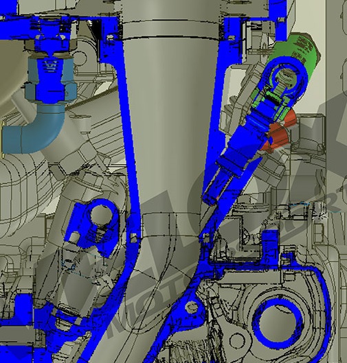

Originally Posted by Hyper4mance2k View Post
Was a design with the injectors out of the air stream and positioned directly above the velocity stack ever considered?
Originally Posted by Turdinator View Post
That just sounds like a tuning issue. Could you put some bungs in the top with plugs that people could pick and choose where they wanted their port injectors? The FA20 with D4S seems like a prime candidate for that type on injection for NA builds.
I am suggesting this gives a cleaner air flow

Old 03-27-2015, 11:45 AM   #244
Hyper4mance2k
Alexandrino_Auto
Hyper4mance2k's Avatar
Drives: series.Blue
Location: Greater DMV
Posts: 1,014
Thanks: 1,584
Thanked 637 Times in 377 Posts
Attachment 105596
than
Attachment 105597
Attachment 105598
Those were just bad examples. When the fuel is injected above the velovity stack, it atomizes better and it doesn't puddle against the manifold like it does in side injection. If it didn't work better, then formula one wouldn't use it.

All the V8 & V10 NA F1 cars used this style of FI.
I'm sure @eric6 can attest that it is a better design, but he has already commented on why they chose to omit that option; and, their reasoning is very sound.
Those were just bad examples. When the fuel is injected above the velovity stack, it atomizes better and it doesn't puddle against the manifold like it does in side injection. If it didn't work better, then furmula one wouldn't use it.
Sure, but keep in mind they have big-time packaging issues that we don't have in the horizontal plane with not much restriction in the vertical plane. Pretty much the opposite restrictions of any front mounted engine. I'm sure there's a performance benefit, but considering we already have DI which is arguably better than any PI, I doubt we'd see much in the way of performance gains by going to those neat top mount injectors. Unfortunately, because they're cool as hell, lol
