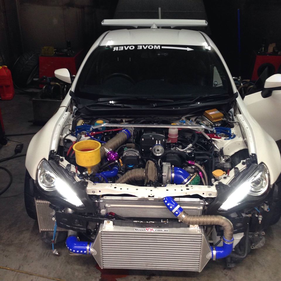

Twincharged with Sprintex supercharger
http://www.ft86club.com/forums/showt...ht=twincharged
https://www.facebook.com/streetfx86/...type=1&theatre
