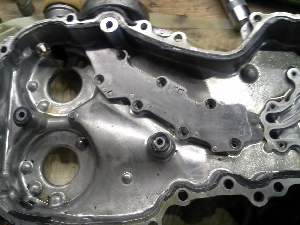

Originally Posted by Andreas83 View Post
I have considered upgrading the rods when I do the rebuild.
I had a quick look on the timing cover and oil pump on what could be ported.
The pump itself looks like it is good as is, but the channels to the oil filter and filter bracket has a lot of sharp edges that can be smoothed out a bit.
I will look in to the books you are suggesting.
I also found out that the cover for the oil ports to the filter was loose.
All the bolts where barely fingertight.
I had to use a impact screwdriver to remove the pump and the cover on the other side.
There are no gaskets for either the covers or pump, so oil could have escaped out here and pressure have dropped.
I just did not have that issue on my list.
As i recently swapped my GT86 for a new one because of various reasons,
i'm really curious about production changes. Some people got their timing covers changed, but i always thought these exchanges were always sensor related.
From first view, everything is cleaner sorted in my new engine bay.
Did you guys at Element Tuning mention any changes on engine internals, especially timing cover/ports/seal related?
I finally like to have a reliable working NA FA20.
