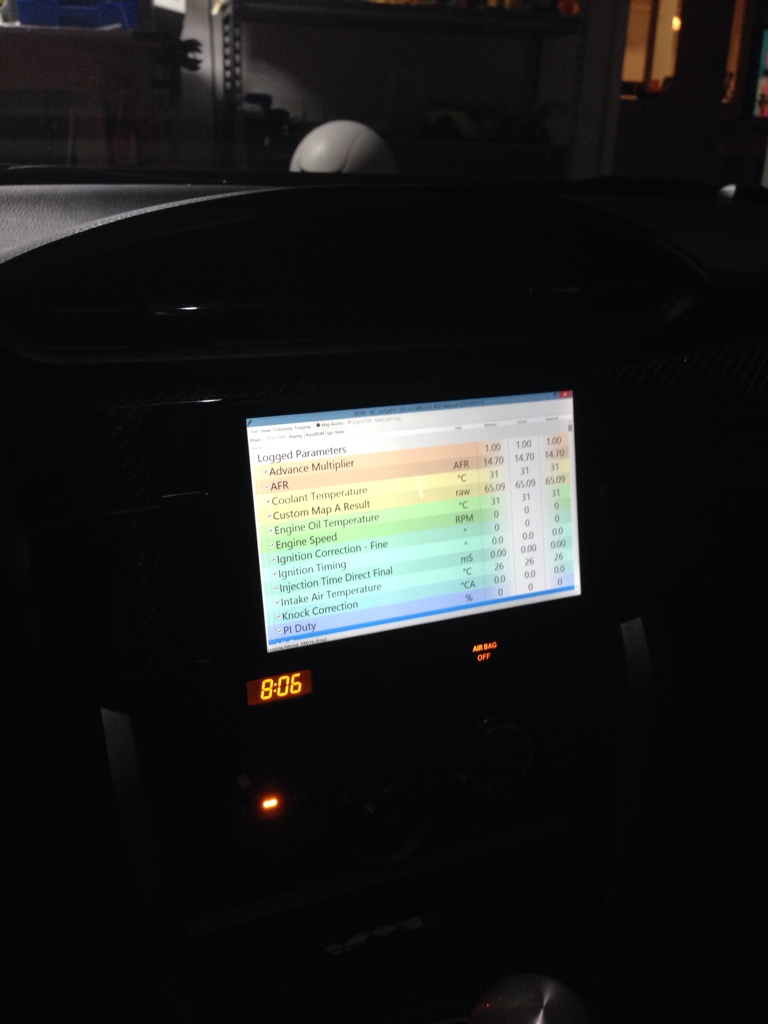

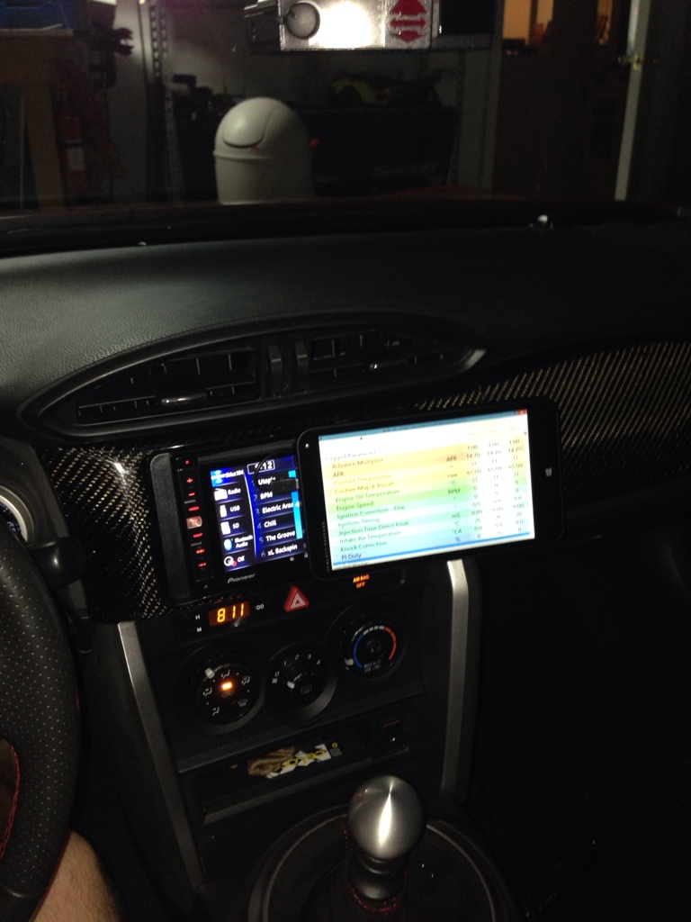

Those looking for an easy , convenient solution to view, log and make changes quickly...windows tablet from HP Stream ($99) works well. Only thing you need is a USB on the go cable and a USB hub.
Increase text size in EcuTek and view critical parameters real time..oil and coolant temp, PI duty, ethanol percentages, AM, ign correction.. Etc
(Oil pressure is Hardwired so that's a separate gauge me)
Make quick changes at the track without that bulky laptop!
Attachment 104017 Attachment 104018
@Jetbill how did you mount the tablet?
Just bent a piece of steel strapping used for lumbar I found in home depot.
It looks like a "U" and added strong 3M double stick to the back. The flat part of the U sticks to the tablet. The edges slide under and over the radio between the external part of the radio casing and the dash bezel. It's temporary of course.
