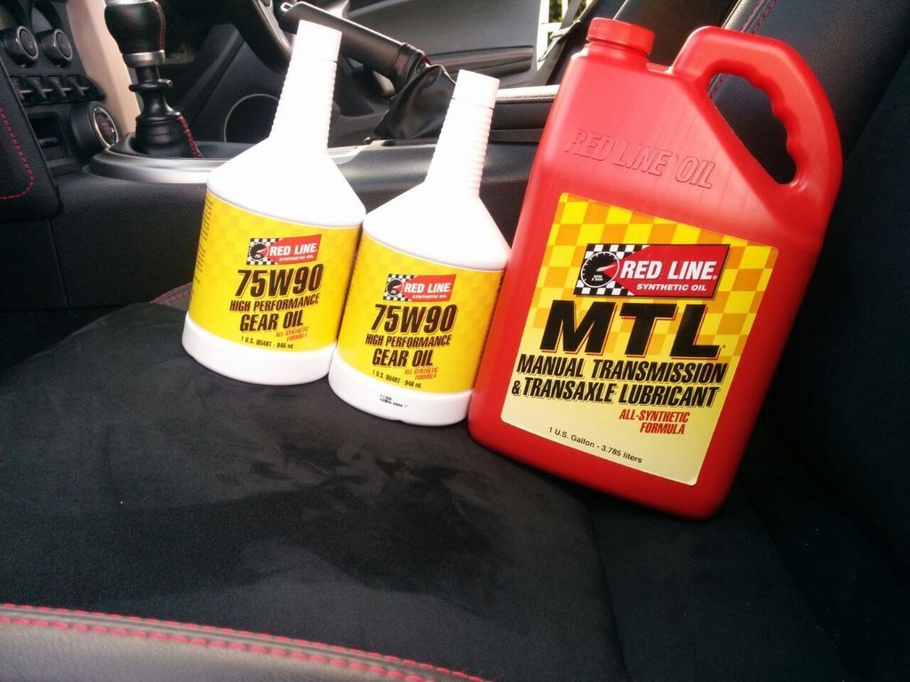

Old 03-09-2015, 08:32 PM   #66
504
504's Avatar
Drives: 2014 86 GTS
Location: Sydney, Australia
Posts: 168
Thanks: 131
Thanked 85 Times in 57 Posts
Anyone have experiences with redline mtl AND mt85? The mtl is much closer to the OEM viscosity specifications however 75w80 is under the recommended viscosity. The red color of mtl kinda scares me too gives me the impression that its very slippery like ATF.
Also I think a good point to bring up is how hot the tranny fluid gets i.e. if it only reaches 90c then the very thin pentosin mtf2 has possibly a 15cst thickness as opposed to the 7.7cst at 100c that everyone quotes.I think it would be a big contribution to this thread if someone could provide some form of quantifiable data on this
504 is offline   Reply With Quote

Edit:
Just replaced the fluid. I felt stock fluid was excellent, it would always let me in gear except maybe my first 2nd gear shift on cold days. The redline MTL feels very similar but a little less notchy and more fluid going into gears. downshifting from 5th to 4th used to catch sometimes and is a non issue now. The difference is subtle but noticeable which isn't a bad thing because I felt stock fluid was excellent. Fluid changed at 13000km; surprisingly both the diff (red) and transmission (yellow) still had color in them. Its great to remove break in metal especially after seeing all the non ferrous material in the differential. Highly recommended!
Further impressions: confirming my suspicions, it does seem the fluid is slightly slipperier than ideal. 2nd gear has a slight synchro catch sometimes (no grind though)
