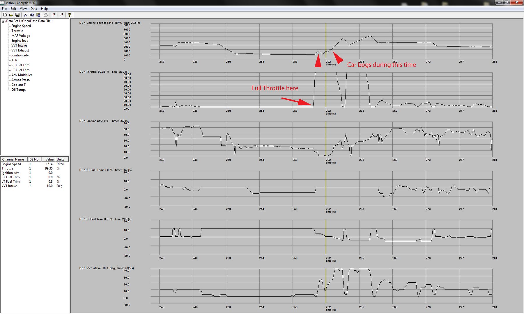

I managed to do a data log for the first time (yay!) and actually recorded an instance with the car "bogging" from a start.
Here is a photo:
I'm not sure I included the right info with the log, but you can see with full throttle that the RPM's actually drop instead of accelerate and the car just doesn't do anything.
I'd expect any car to do that in gear at 1500rpm.

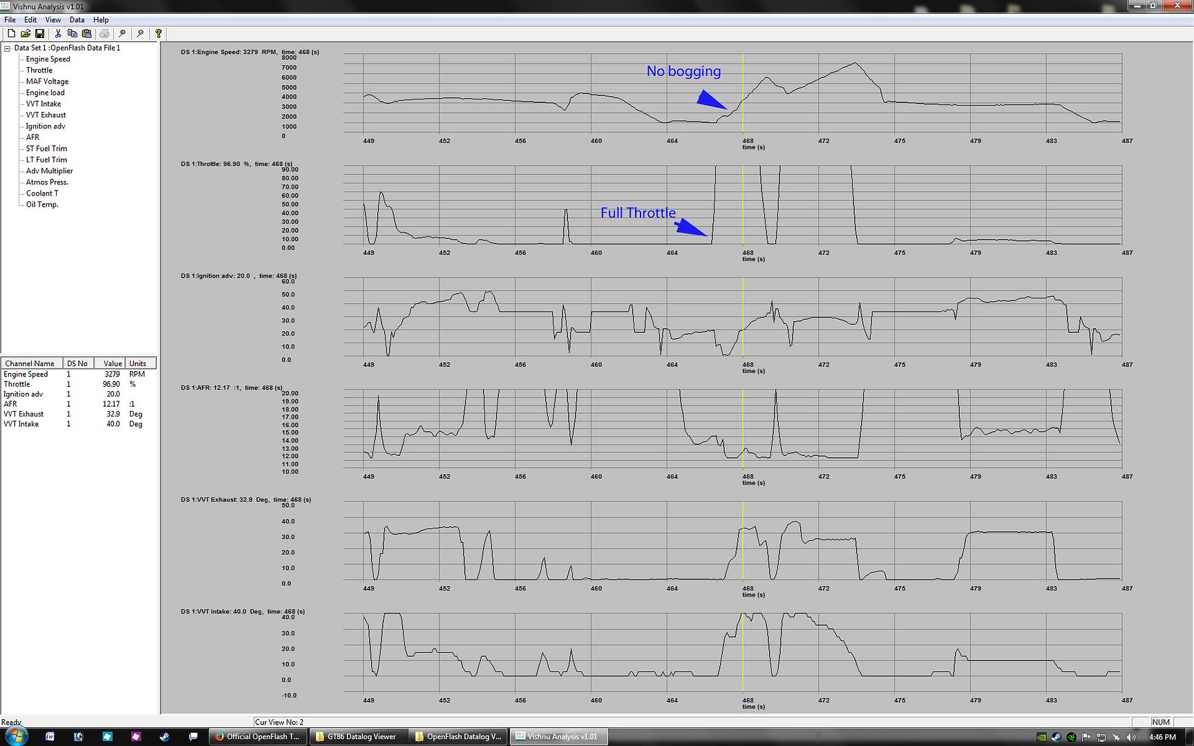

It was at idle at a stop with the clutch out. Basically a launch with trying to avoid a burnout by revving the motor and dropping the clutch.
Here it is a little later, same situation but didn't bog...
Basically, the car right now is very finicky with acceleration from a stop... Either its a normal/granny start, or you have to rev it and drop the clutch. If you do anything else in between, you wind up with a bogging situation a lot of the time.

Coolant T?

Coolant Temp was 182 (oil 156) during the bogging pic, and 192 (oil 195) during the second non-bogging pic.
