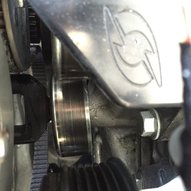

I had a belt problem as well, but not the Kraftwerks S/C belt. My accessory belt fell off after a hard shift into third. See my other post here. http://www.ft86club.com/forums/showthread.php?t=81319
My car overheated cause the water pump stopped working. I towed my car home via AAA. The next morning I found that one of the OEM idler pulleys seized (the one to the right of the crank).
I have a new part coming on Tuesday. Hopefully replacing the seized pulley will fix the problem. Hoping it won't be too much of a pain in the ass to remove the KW/Rotrex assembly to get at the idler pulley.
Attachment 102074
I will be replacing my accessory belt as well when I install the new SC belt & pulley's. Are there any better accessory belt than OEM out there?
I'm only aware of one belt claiming being higher quality than OEM - Gates Racing Blue http://www.rallysportdirect.com/Gate...tine-Belt-Blue
I just went with another OEM belt (the OEM one I had was a Mitsubishi) since I don't think it was a problem with the belt itself.
