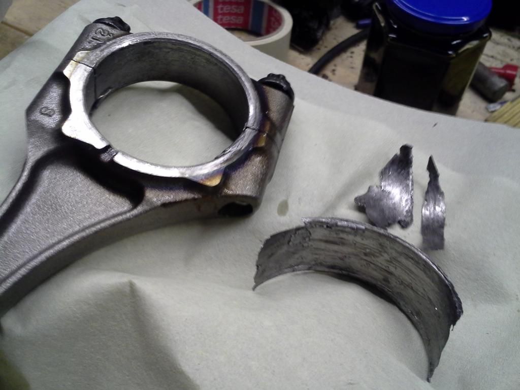

Originally Posted by CSG Mike View Post
What caused you to run low on oil?
The cover over the oil ports to the filter was loose...
Heard the knocking sound, pulled over and got the car towed.
But the damage was already done.
I was logging while it happened, oil temp went up high in no time...
I am really glad it did not happen a couple of weeks earlier. long road trip in europe.
Drove in the alps, nurburgring & autobahn.
I am installing a brand new oem crank, BC rods and new bearings.
Got the block inspected, its still ok.
So what caused the cover to come loose?
I have no idea, built on a monday perhaps.
The motor has never been disassembled after it left the car factory.
Not covered by warranty due to mods...
The oil pump and the cover on the other side was ok.
But the cover for the oil filter passage was loose.
Wow man that sucks.
Nodded how? I thought u were NA?

The car had a full exhaust, BPB, intake, tune, catch cans and oil cooler+++
I could probably have argued about it, but that would probably have taken forever.
And if i had lost, it would have ended up costing me alot more.
