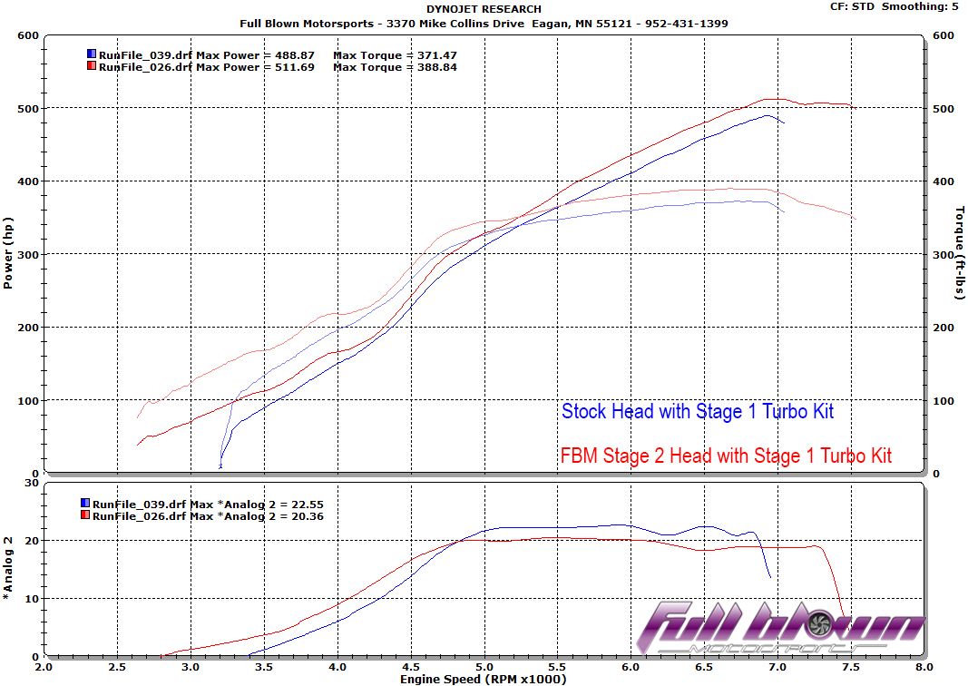

So any base line dyno results where the only change was the head work ??

We just wrapped up another clients car and it was nice to get some comparison with an identical setup.
Both engines ran the same compression on our stage 1 block. Only difference was the blue line was using a complete stock head. You can see that we made more power on less boost and the increase in spool was very noticeable.

That's with the cams correct?

Yes complete stage 2 package with cams.

Is the engine idle behaving on cams?

Stock Idle

The cams are pretty lumpy from the factory. I'd guess that FBM is removing some of the lift and/or duration from the exhaust cam to help spool the turbo. Add in the better head flow and the results is more power everywhere. If I'm right idle would actually be easier.
Just a guess though.
