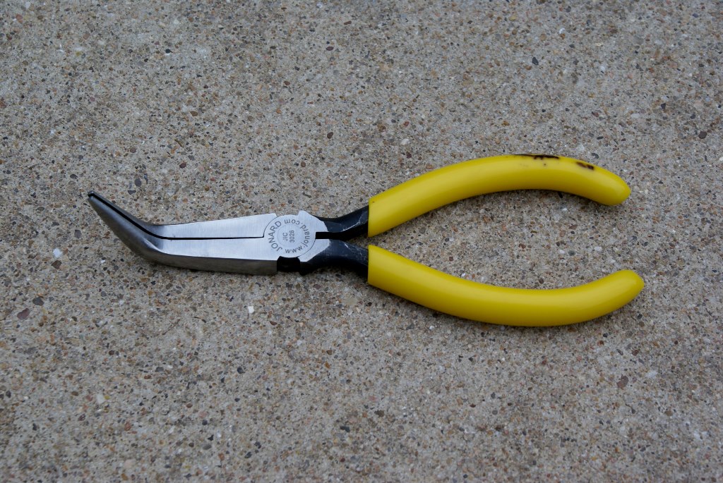

With regard to the clutch pedal adjustment, I took care of it this morning on my 2015 FR-S. Much better action and a predictable point of operation. Fast too. As it turned out, I did not need to adjust the cruise control switch position; everything worked normally after moving the pedal.
I strongly suggest that anyone doing this adjustment get a pair of "bent" needle nose pliers from their neighborhood Radio Shack. This greatly eases the adjustment of the rod itself. The angled tip really makes it much easier to get around while standing on your head!
