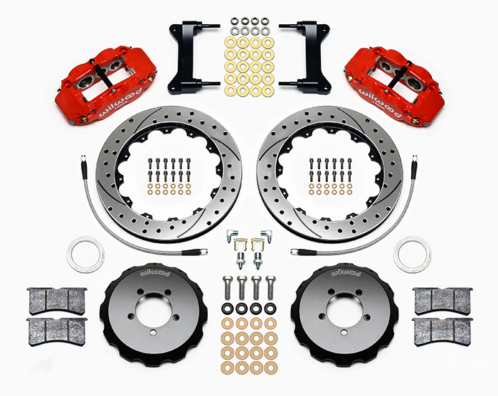

Wilwood makes one (edit: sorry, not sure if it will fit "stock")
http://www.wilwood.com/BrakeKits/Bra...BRZ&option=All
