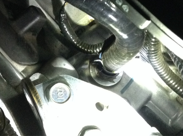

Installed mine, nice and clean. Did everyone use a hose clamp on lower hose on top of the engine? The factory hose didn't use one. I had an extra spring type clamp that I used.Name:  ImageUploadedByTapatalk1420768908.926155.jpg

I used three of included clamps on the following areas:
Both in/out of the catch cans.
Pcv valve connection.
I am adding a clamp to the Intake manifold connection.
Sounds like these kits are missing a clamp! We intended for each hose connection to use one of our included clamps. Sounds as if you guys have sorted out a solution, let us know if you would like us to send out an additional clamp!

John I think it's intended as the video didn't show a clamp on the intake manifold. Am I wrong? Would love to know.
