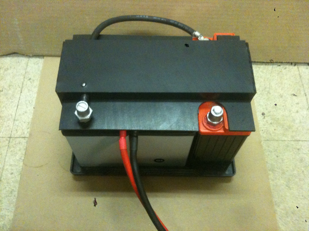

Attachment 98414
ETX16, simplified (no pre-fab/tape) and ~4lbs lighter than 1.5 powersonic dump, better 6mm bosses (PC680) for starter.

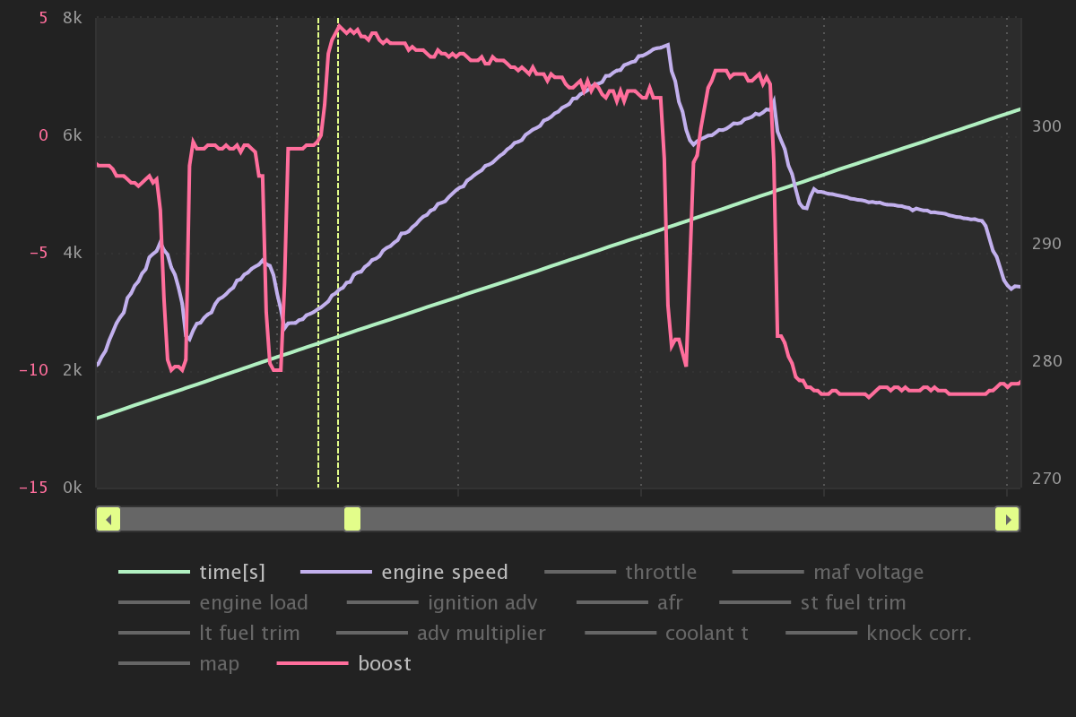

Recent log (Bu-Tang) quicker spool time... 0 - 4.7psi(3200 rpm) in ~500ms. Near NA slope/responds. Light wheel & software mod.

Interesting. I was somewhat skeptical of the Bu-Tang log, due to the lack of throttle graph, and measurement going from 0 to full spool instead of from full vacuum to full spool, but after looking at my own logs, even at half throttle, vacuum immediately drops to ~0 psi before the ESC is ever engaged.
After examining three different runs, the instant full throttle is reached/ESC engaged, untill peak stable boost is reached, my logs all show ~.94 seconds. So 500ms is damn close to a 50% reduction in boost lag!

5. The new batteries, so better starter battery, and the new dump pack option provides approximately the same? better? performance than the 1.5 pack? 4.7psi at 3200 rpm is on average almost exactly what I am getting on my setup with dump 2.0. With my peak being a rare 5.08psi at 2700rpm. How is the cold vs warm performance of the new dump pack? does it require the same amount of warmup for peak performance as the old?

5) dumps: better performance and can handle more amperage. By better I mean they warm up faster.
Starter: it's an odyssey
