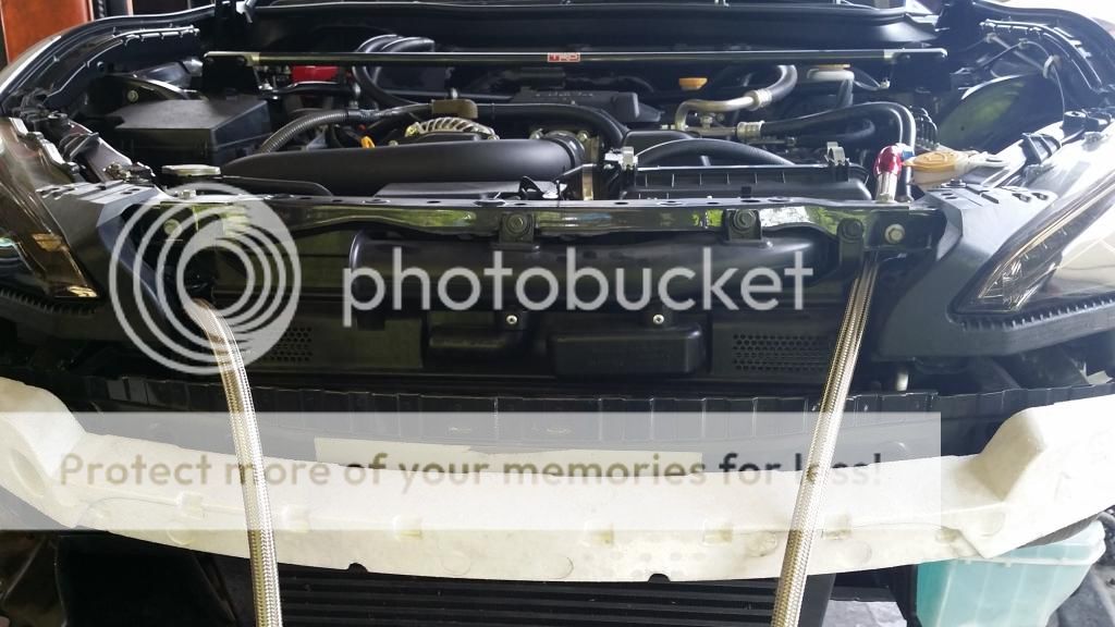

I got an AVO oil cooler
I've had the AVO stage 1 for a year with oil temp up to 240F and water temp up to 200F. After the oil cooler, oil temp up to 200 and water temp up to 195.

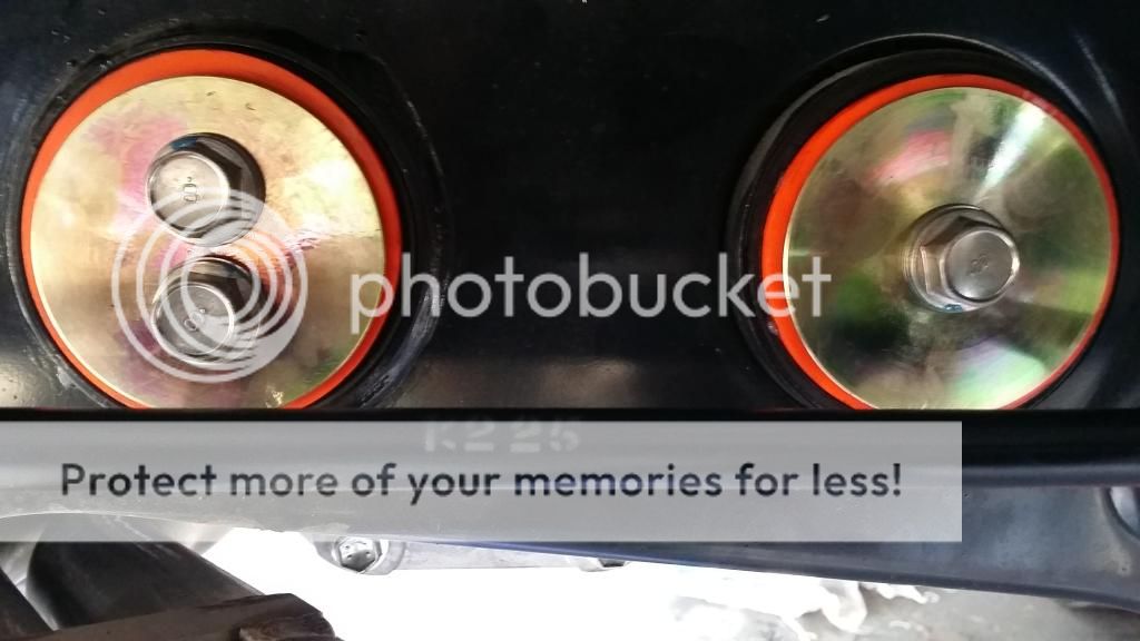

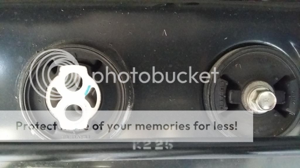

I got the anti tramp differential bushing. Power seems to be more instantaneous. Guess it works and it was easy to install.
