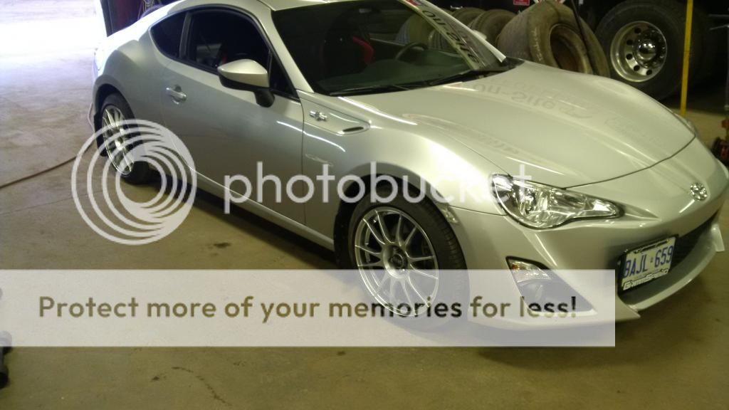

Sorry for the crappy pictures, just got these on today!
Originally Posted by Createddeleted View Post
Any idea on how much camber can safely be run with this setup? I'm not looking to run more than -1.5. I believe it would clear but I just wanted to see if anyone was running it.
Im running whiteline camber bolts and have no problems.

What tire size is that?

Im running the stockers for now. So 215/45/17

what size are these? 17x7 ET48?

Nope 17x8+35 all round

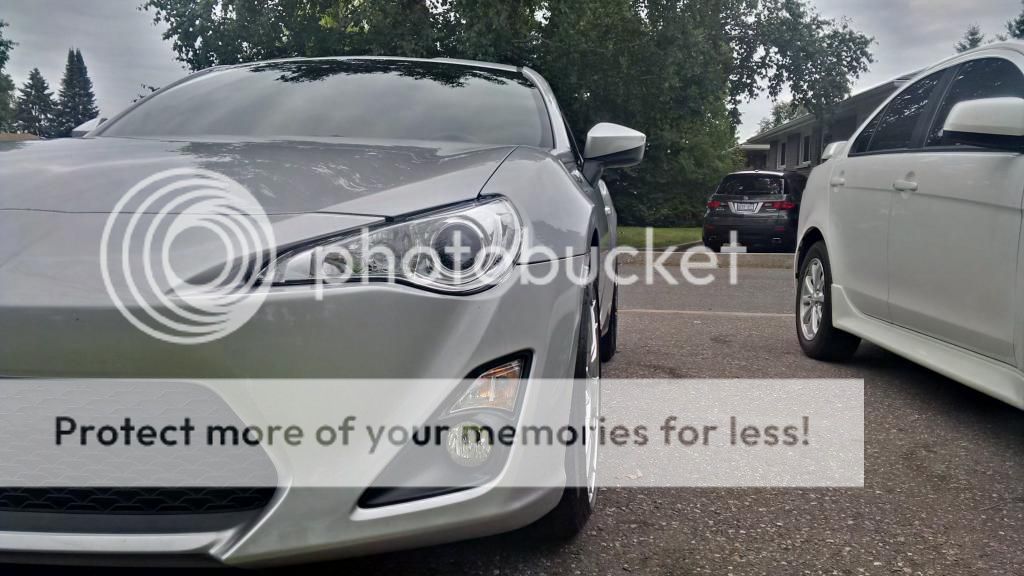

I try looking at the comparisons between 48 and 35 offset...
I really can't tell the difference.
Can anyone take a better angle shot to show the relation of the wheels to the body for both offsets?
Also does the 35 offset fit the AP racing kit?

+35 sits flush (maybe even some 'poke') with the fender. +48 the tires would be sunk in like OEM.
+48 see how the rear wheel is 'sunk' in?
In reality the difference is only 13mm. Less than an inch
I would assume they fit the AP racing kit

Well, not exactly. +48 is the same offset as stock so the wider OZ wheel will be less sunk than the OEM wheel by 1/2". But, in general, yea, the +48 8" wide OZ wheel will still be sunk in a little bit.
