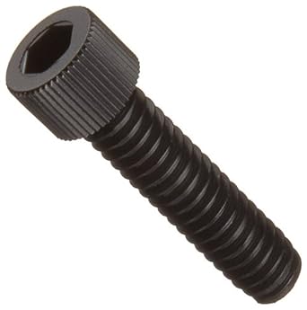

Did you guys actually use the hex key that the TRD instructions asked for?
That's the only thing I don't have, and I don't really want to get one if it isn't absolutely necessary...
Yes. IIRC it's used for the bolt that actually threads into the adapter piece.
Been a while, but it looked like this:
So, good luck getting it off without that. Just buy a cheapo set at your local parts store, something like a pack of 10 for probably $8 or less.

Yup, just get a ball-ended hex socket from Lowes or something. It's only a couple of bucks.

Honestly, I couldn't find any of my ball-ended hex keys, and it was going to take a week for the local autoparts store to order one( and it had to be ordered in a kit). The guy at the counter didn't even know what I was talking about at first. I had to describe it in detail and then he had to look it up. Anyway, I just bought a regular hex socket and found it worked perfectly fine. Not sure why you would need the ball end.
