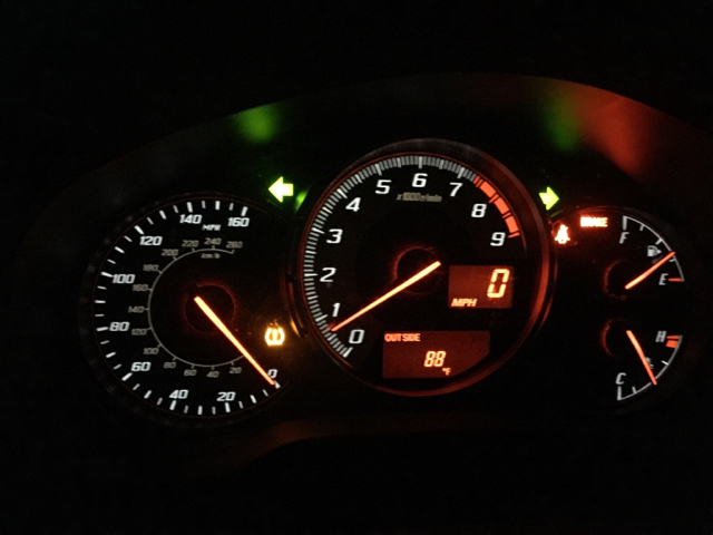

I did this method and everything works, however, I noticed this
When I turned on the parking lights/headlights. The only things that are lit are the side markers and nothing else, but when I signal everything works as it should. I'm just wondering if I wired it incorrectly or does everyone have this problem.
Just in case you guys were wondering, my side markers are LED not the standard bulbs.
Attachment 121165
Function should be as below. Do you mean when you turn on your parking lights, the sidemarkers light, but not the front blinker bulbs? If so, your front blinkers are not getting power until the blink for the signal is triggered.
1. Parking lights on, the side marker will stay on / front blinkers on - and alternate with the front blinkers.
2. Headlights on, same as #1.
3. All lights off, the side marker will not be on but will blink in sync with the front blinkers.

Everything works as it should, the issue is whats going on in the gauge cluster. And I previously removed the green wire from the front signals, because I did not like the lights on as DRLs.

if you put the green wire back, does your cluster look normal?
use techstream to disable the drl's or have dealer do it, most do it free..

The cluster looked normal when I had the green wire removed a long time ago. I had the DRLs turned off a long time ago. The green wire is what gives the front signals the DRL look. I'm wondering if anyone else that did this mod has this issue, esp if they have LEDs in their side markers.
