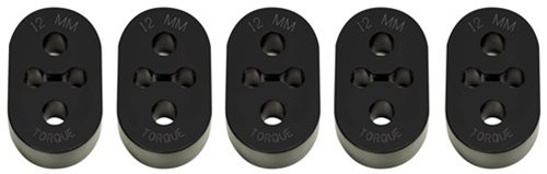

Since the extra mechanical grip is now allowing a lot of exhaust movement as evidenced here:
I just ordered a kit of Torque Solutions 75A durometer 12mm exhaust hangers to help keep my new catback secured on track.

I can see those helping up and down motion, but I don't know about it helping your side to side motion. I liked the idea one guy had to just put some C or E clips on the exhaust hanger to stop the side to side motion. My other solution would be to drill a hole and just use a cotter pin.
Yeah, the C clips definitely help, but the real issue is the OEM rubber hangers get mushy when they get hot, and with enough lateral load, they will pop off. When the track cleared, the safety crew and I got underneath and literally just slid the hangers back on like it was nothing; when initially installing it I almost broke my fingers putting so much pressure just to try and get the hangers on.
