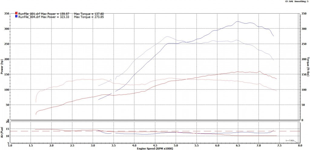

This is just a sample dyno provided by Treadstone Performance @ 14psi (93oct I believe)
Attachment 88129
Those are almost the exact same
Dyno numbers I got with my kit lol
Resistance- Because if we fight we might lose, but if we don't fight we've already lost.
That isn't my dyno chart, I grabbed that from the website as an example haha

Lol then that is my dyno chart

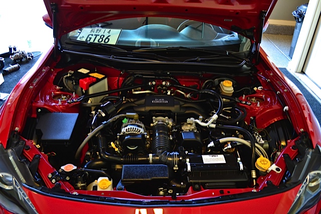

**8/22/2014**
All of the mechanic portion of the build is complete, we just now have to wait until we can get a base map tune for an AT car so that we can get the car started and check for any problems or leaks. They had to relocate the oil cooler to mount at an angle in front of the bumper reinforcement. The second post (#2 above) will show pictures of the finished install.

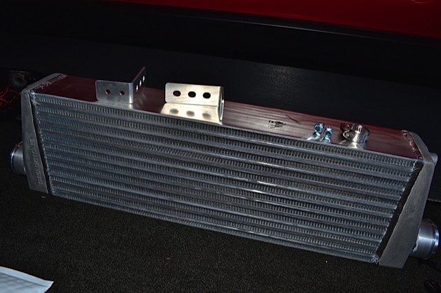

No sir, it mounts directly on the backside of the bumper reinforcement.

Results are up! Check post #3 of this thread.
connor_lol is offline   Reply With Quote
Old 09-19-2014, 01:09 PM   #26
cdrazic93
Junior
cdrazic93's Avatar
Drives: a car
Location: Probably at school
Posts: 4,341
Thanks: 3,184
mmm dat torque doe.
