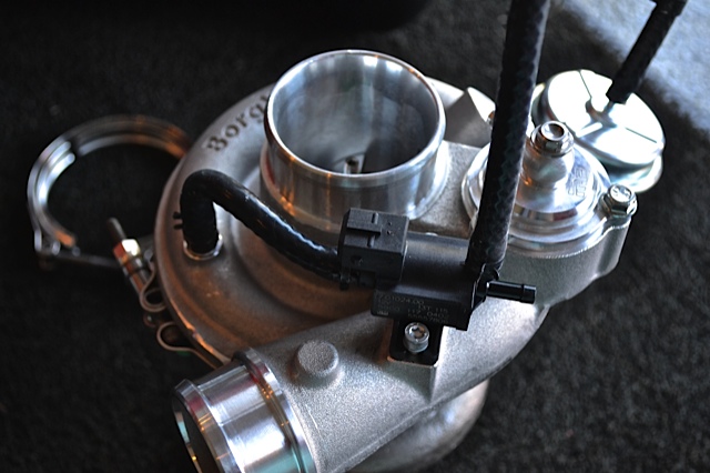

Borg Warner EFR 6758: Compressor; 67mm Exducer, 53.9mm Inducer, 49lb/min max flow rate, w/ an electronic boost control solenoid. Features Gamma Ti turbine wheels, dual ceramic ball bearing cartridges and investment cast stainless steel turbine housing.

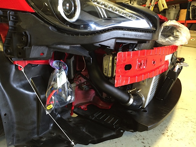

The install is moving along over at Touge Factory, it's tough because the kit didn't come with any instructions, so we provided them with as much information and diagrams as possible. Below is a picture (post #10) of the progress!

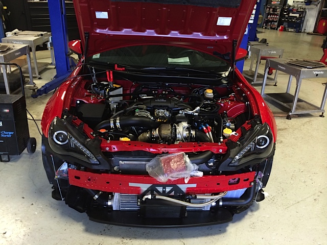

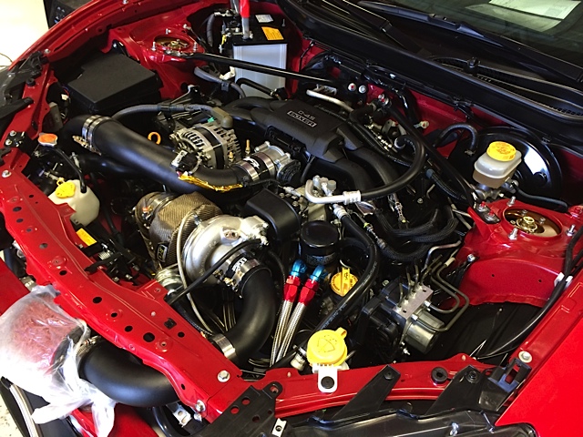

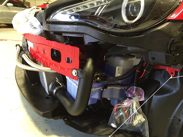

All of the mechanic portion of the build is complete, we just now have to wait until we can get a base map tune for an AT car so that we can get the car started and check for any problems or leaks. They had to relocate the oil cooler to mount at an angle in front of the bumper reinforcement. The second post will show pictures of the finished install.

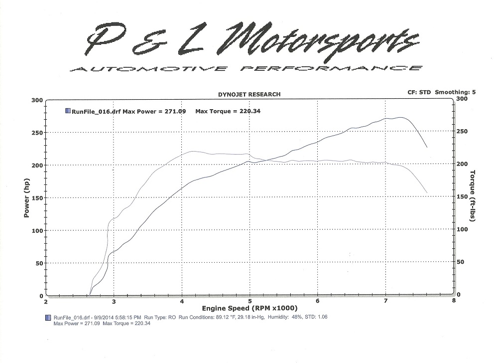

Sorry late post, been driving the car for a week now. It made 271 rwhp with 220 torque @ 10psi on 93oct. I am extremely limited due to having only a fuel pump + stock injectors. In the Spring I'll be doing a retune with bigger injectors to get me around 325. Car though runs great. About 150 miles on the kit with no leaks. Runs a bit too rich under boost, but that can be tuned out. Extremely happy with the results! Up from 167 rwhp stock. All I can say is WOW. Completely new car, the power is awesome. I've never owned a turbo car before, and I have to say I love the boost. If anyone hasn't felt a turbo/sc 86 yet, I highly recommend you do. I really wanted to give a big thanks to all the guys at TF and P&L for the great work, and friendly customer service.

The car made 271 rwhp with 220 torque @ 10psi on 93oct. I am extremely limited due to having only a fuel pump + stock injectors (on 90% max duty cycle). In the Spring I'll be doing a retune with bigger injectors to get me around 325. Car though runs great. About 150 miles on the kit with no leaks. Runs a bit too rich under boost, but that can be tuned out. Extremely happy with the results! Up from 167 rwhp stock. All I can say is WOW. Completely new car, the power is awesome. I've never owned a turbo car before, and I have to say I love the boost. If anyone hasn't felt a turbo/sc 86 yet, I highly recommend you do. I really wanted to give a big thanks to all the guys at TF and P&L for the great work, and friendly customer service.

connor_lol 08-19-2014 02:15 PM
Just an update pic, the install is moving along!
Attachment 88552

kbye 08-19-2014 03:28 PM
Looks good, how is the fitment of everything? Any cutting or drilling you had to do?
connor_lol 08-19-2014 03:31 PM
I haven't seen the car personally yet, but I do believe there isn't any cutting or modification of anything thing yet. Just some relocating of my oil cooler and the factory horn. Oil pan does need to be replaced, but otherwise thus far it is basically all bolt on.
