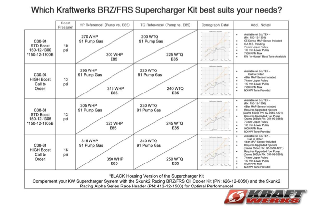

Originally Posted by mit_peid View Post
Attachment 88208 Found this on the Kraftwerks FB page. Might be useful info for some of the folks on this thread (although it seems as though they may have overrated the HP numbers a bit for the base c30-94 kit). So when's the CARB approval coming again?
Our car is in the 'lab' right now being tested. We're waiting on some of the last tests to finish up before we hear the outcome.
Once approved, we have not been given a time-line as to how long it will take to roll out the certification, EO numbers, etc.
