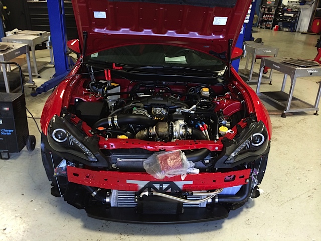

The install is moving along over at Touge Factory, it's tough because the kit didn't come with any instructions, so we provided them with as much information and diagrams as possible. Below is a picture (post #10) of the progress!
**8/22/2014**
All of the mechanic portion of the build is complete, we just now have to wait until we can get a base map tune for an AT car so that we can get the car started and check for any problems or leaks. They had to relocate the oil cooler to mount at an angle in front of the bumper reinforcement. The second post will show pictures of the finished install.

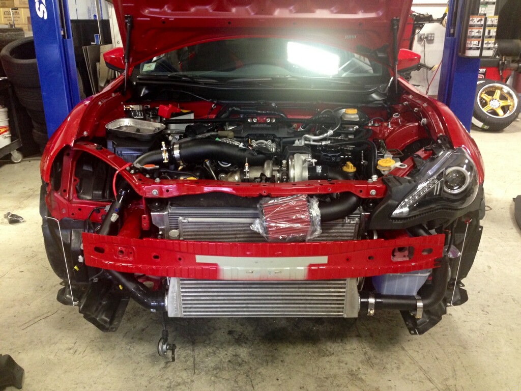

Just an update pic, the install is moving along!

Old 08-19-2014, 04:01 PM   #11
Attachment 88552
Looking good!
I sent your dad some pics for the install (coolant & vaccum lines & bcs wires). Let me know if you have any additional questions. You can PM or text me (210-246-3939).
Kelly

Looks good, how is the fitment of everything? Any cutting or drilling you had to do?
I haven't seen the car personally yet, but I do believe there isn't any cutting or modification of anything thing yet. Just some relocating of my oil cooler and the factory horn. Oil pan does need to be replaced, but otherwise thus far it is basically all bolt on.
