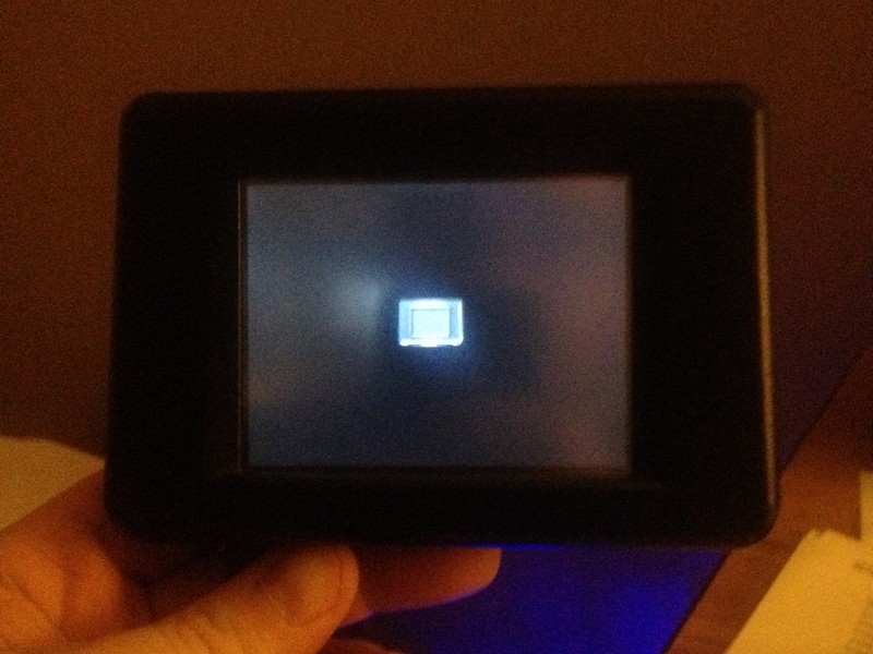

I'v got an issue I can't seem to fix. My OFT will no longer connect to the OFM. I've tried reinstalling OFM and switching USB ports on my computer. Nothing works. And yes, I do know to open the OFM before connecting the OFT. Anybody got any ideas of what the problems is? BTW, my OFT still works fine in the car.
Edit: In the photo, my OFT stays on this screen when I connect it to my computer.

Its obviously getting power via usb port, but not connecting software wise
try new usb cable
try on different usb port
make sure no other software is trying to access usb port ie phone software
try different computer or friends computer
try turning of antivirus/firewall software
call openflash guys

Before you do anything, when you plug it into the PC, does the PC acknowledges that the usb device has been plugged in?
If not, then this is a driver issue and you should go into control panel and remove the usb device that it thinks it's plug into the USB Controller and delete it.
Then reboot the server because WINDOESZ and try plugging it back in.
DO NOT DELETE THE USB CONTROLLER, just the device attached to the USB controller.
thank you.
