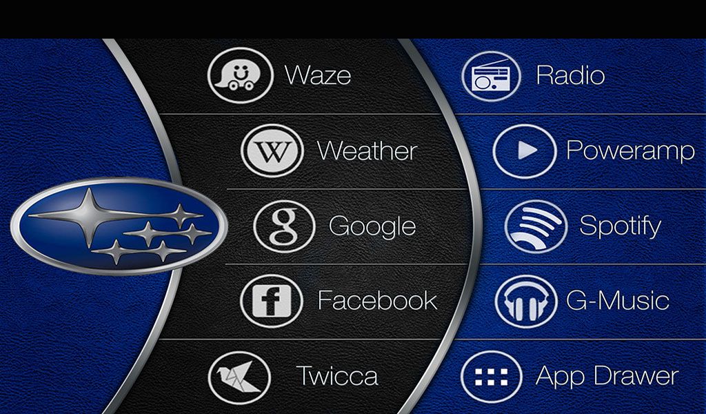

Got mine a couple weeks ago. Getting it all set up now.
Got the idea from here
http://www.mp3car.com/show-off-your-...log-diy-2.html
Nova Launcher.
Froze CarHome launcher in Titanium Backup. Doesn't seem to stay in standby mode all the time. Haven't figured out what keeps it in standby sometimes and sometimes not.
Using Home2Shortcut to remap some of the buttons.
https://play.google.com/store/apps/d....home2shortcut
Zooper widgets. Made transparent widgets that act as shortcuts to each app.
https://play.google.com/store/apps/d...g.zooper.zwpro
The black bar at the top is where the built-in notification bar is.
Also using multipicture live wallpaper. You can set it up and have 2 pages with different apps on each.
https://play.google.com/store/apps/d...r.multipicture
Here is my folder with all the files. My subaru psd file is organized like my junk drawer but it's all customizable.
https://www.dropbox.com/sh/2fr9csv6x...lLvcOO75Xo7IVa
