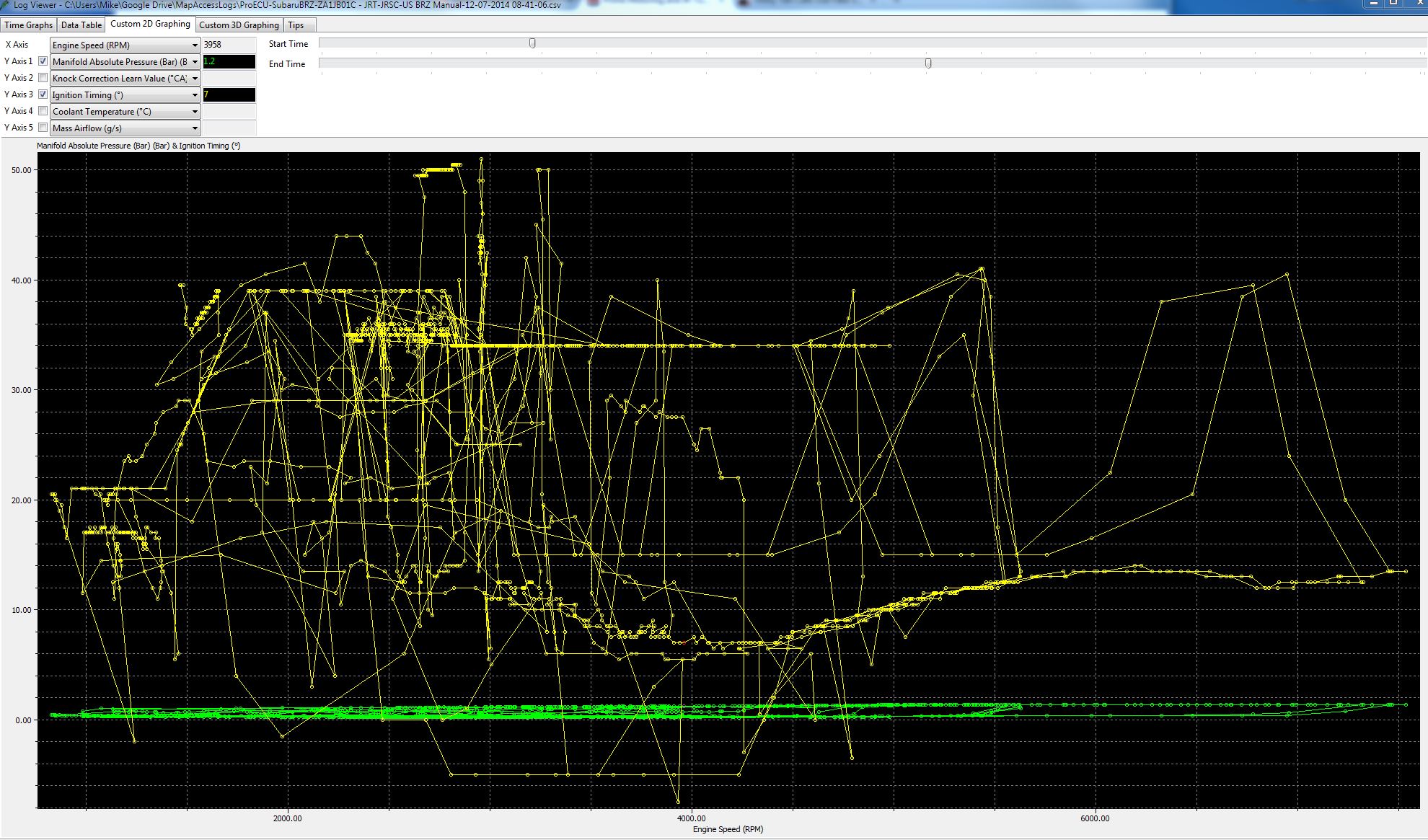

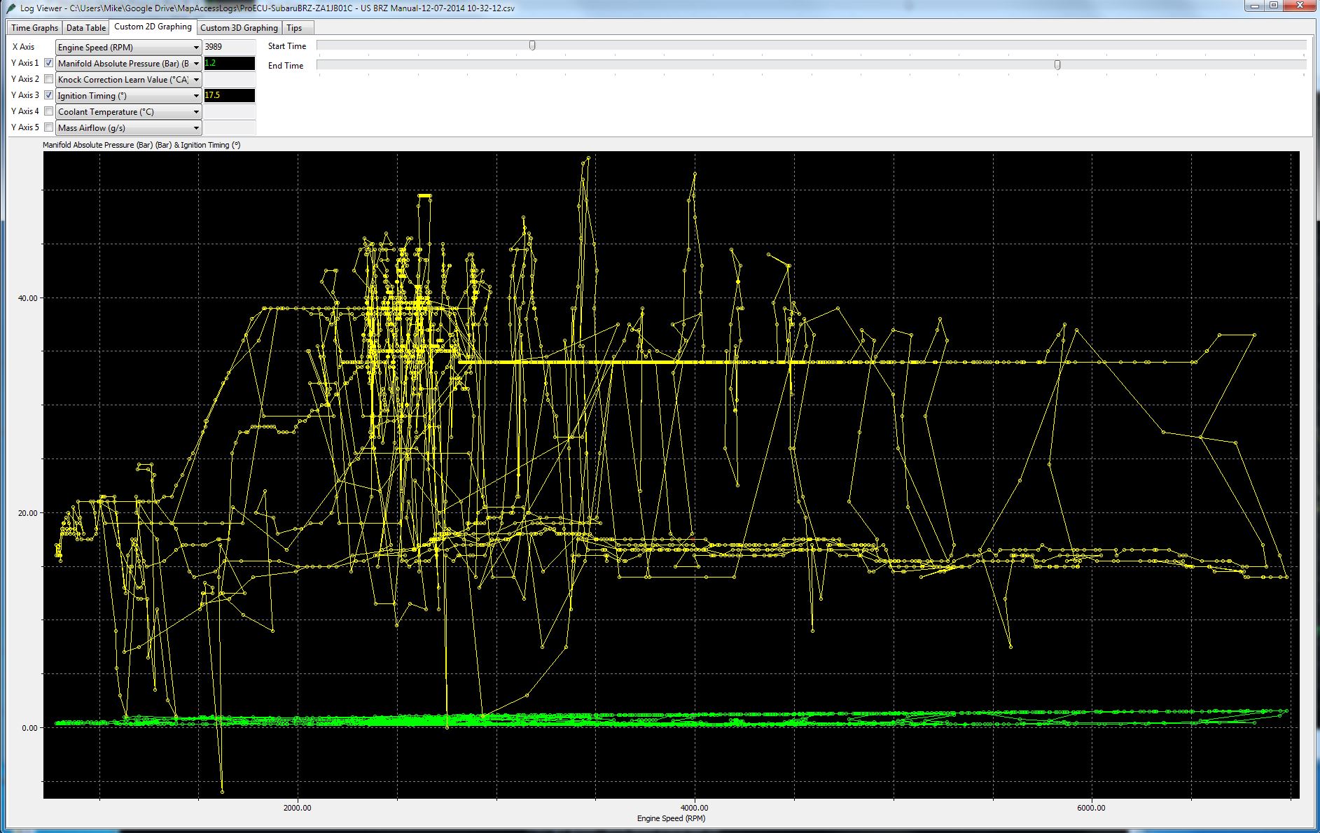

This is not how I like to be mentioned. Now that our name is all over this thread and both parties showing email screen caps, lets first clarify about what this little "hole in the wall in PA" did here.
First off, DP1 contacted us to get a clutch put in, and have a look at the car because he thinks it should be faster. He is having doubts given the number of time another shop has had it. At first we had no clue what shop it was, only later on after we agreed does that come out. We take the car in because it is an easy enough thing for us. The car gets here and he first wants to tune it on the old clutch since it was coming out. Ok. At this point we knew who did the tuning and have seen published dyno charts, so my words to him exactly were that "I don't know if we'll improve, but if we can't I won't charge you." Remember he came for a clutch job not a tune.
We start driving. The car is rattling and the clutch is chattering. The car has a slight exhaust leak, drives as slow as stock. I'm puzzled. We hook up EcuTek to see if there's a mechanical issue. What do we find? Log is screwed up, won't report IAM (or shows 0), FKLC is way off, and it definitely runs like a turd. Screencap of the timing curve:
What you see is that it is the timing is down to 7 degrees in the low range. I can't tell if it is tuned that way or if it is because the AFR was 15 in the low range. Whatever, at this point we tell him we can definitely improve the tune. Sure enough after about an hour of tweaking it, we get it much faster. But it took longer than expected so I began to wonder if we had other issues.
Here's our final timing curve proprietary info be damned, a Rotrex setup does not need to be tuned like a turbo. No need to pull out 10-15 degrees out of the low end when it only makes 2-3 psi.
The other aspect to this is that this USDM car somehow came in with a JDM (G) ROM. Not sure how that happened, some tuners know how to get around this and we had to do that to convert back to a USDM ROM.
So then we got the car on the lift. Not to look for issues to bash another shop, but to do the clutch we were asked to do and confirmed a problem with. We did not offer any discounts whatsoever. But what did we find? RTV all over the exhaust. Head flange, vband in the header, vband in the exhaust, front pipe that had a warped flange...then my tech gets to pulling the header off, and there's only one nut on the passenger side head. A bit of an issue since they are a fine pitch PITA to find shoulder nut. But what do you know, as I look through my tech's cart I see them on the front pipe--they were holding together the front pipe bolts.... Then as we're working on the header, we hear a rattling. Shining the flashlight inside, we see a shrunken and melted cat. When that happens it isn't a defect. That happens because of an overly lean mixture and retarded timing. That doesn't take an expert to put it together when the datalog showed what it did. Metallic substrate cats MELT, not shatter like the OEM ceramics. No doubt track time accelerates the wear, but this rarely will happen after a dozen track days let alone just a few.
As with any job, we tell our customers EXACTLY what we are doing, and why a job is taking longer than expected. Our floor plan is totally open and it is obvious to see what we are doing or cursing at. Here we had to give him a choice as to what to do with the header. He can run it as is, it flowed enough for probably 240 whp, or we can cut it out and reweld the pipe. It is a weekend, he's from 2 hours away, there's no waiting for a P&L warranty unit. So we did just that. Got it back together and drove it, thing picked up another 20hp.
I told DP1 to go easy and keep us out of it, I'm not looking to pick a fight with another shop, nor do I know what may have gone on before hand. I have no control over what a customer does and how they handle their relations with a previous shop, but frankly the amount someone spent and how they were treated has absolutely everything to do with it. It didn't help that when tried calling and emailing before anything was public, he was being told some not so nice things. Those emails you're quoting I'm pretty sure he was acting content as he was trying to be NICE to you and just let you RMA the clutch and maybe refund the tune. Out of context and irrelevant at this point.
We always try to explain to customers that sometimes there's folks we can't always control (i.e. techs, bad parts, sloppy fabricators). I understand being defensive when a customer is ticked, but it isn't cool to attack their credibility, say that another shop is out to get you while quoting their name in a post, reference the Vinny Ten video (someone else I know, but I remember his Supra from 15 years ago when I was racing my DSMs...), call someone's hard earned shop "some hole in the wall," or go after a customer's character.
Again, this wasn't a case of "lets find shit wrong", but a case of explaining to the customer why we were doing what we were doing, and offering options for things like the cat. Not our first rodeo getting a customer that isn't thrilled, and you can bet we always offer a courtesy to the other shop and just fix the issue if it can be fixed. But it wouldn't be fair to throw P&L under the bus in this case either.
