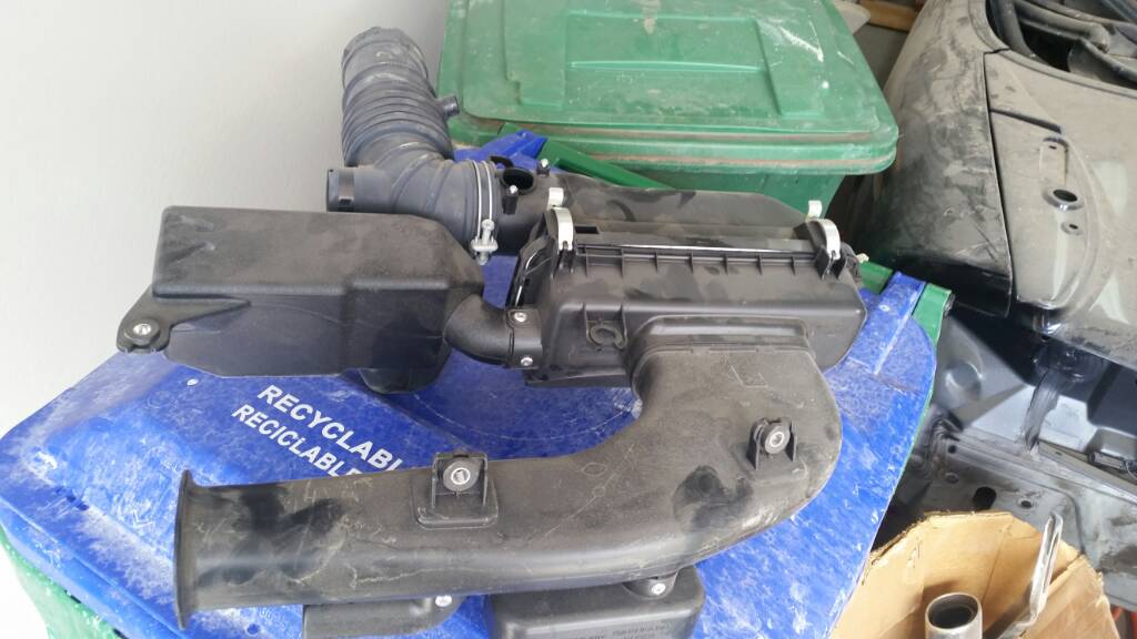

Size:  71.6 KB I think this is the whole air box assembly right.
B.Rice85 is offline   Reply With Quote

Originally Posted by B.Rice85 View Post
Attachment 84192 I think this is the whole air box assembly right.
Yes it is
